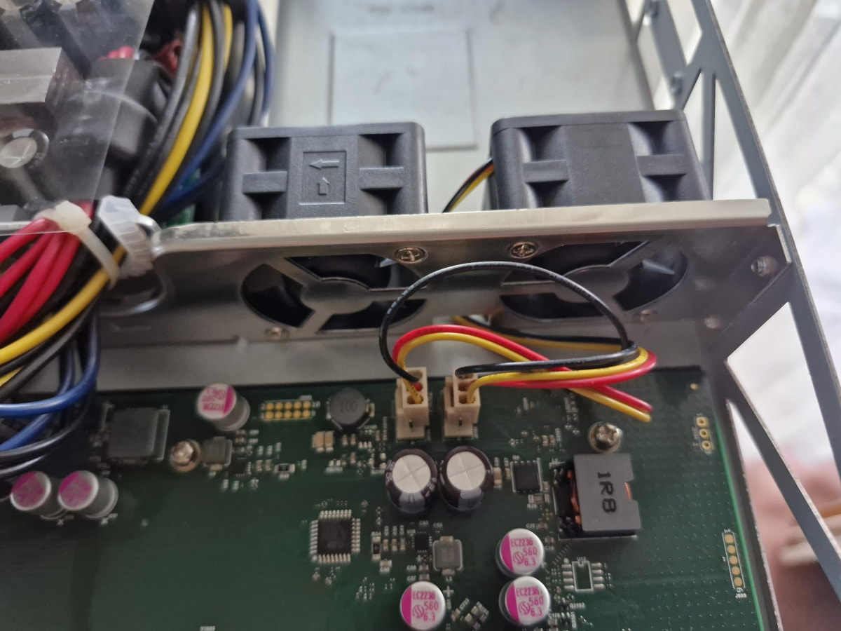

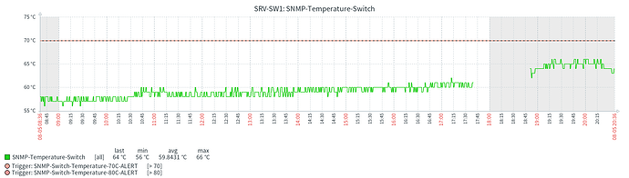

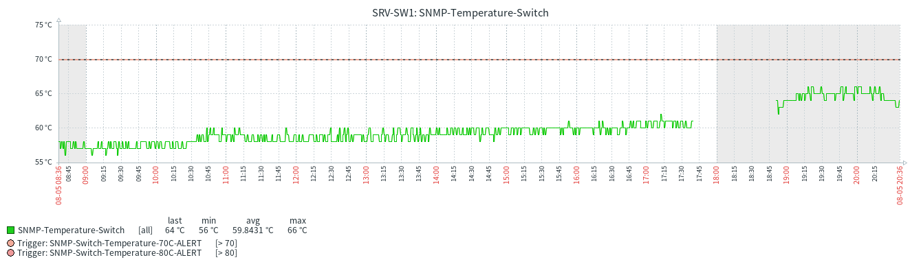

Hi, I replaced the stock-fans with the Arctic-fans. They are much more silent, the temperature (switch sensor) increased by around +5°C. I could hear the stock fans through a closed door, with their high-screaming-noise.

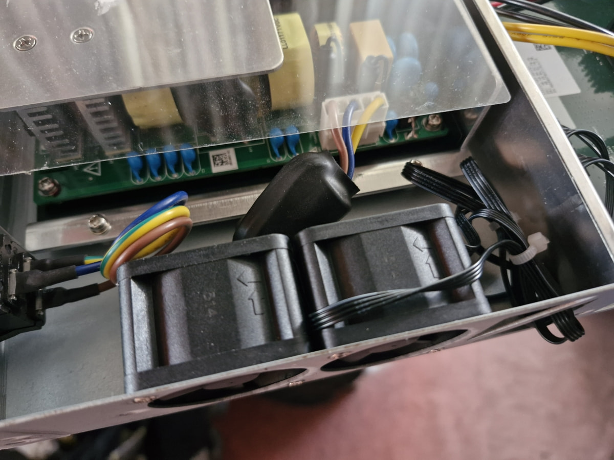

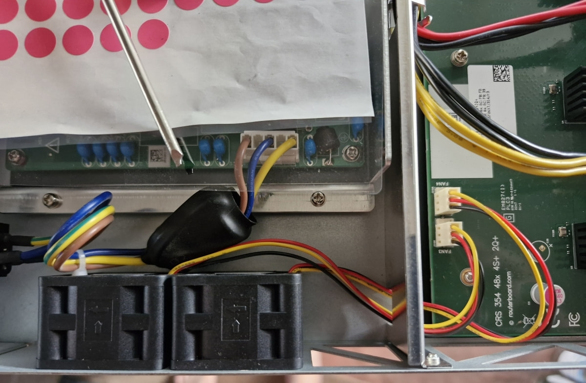

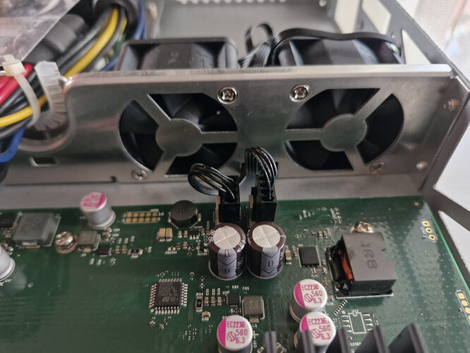

The replacement-process itself is for the inner fans (fan 1 and 2) difficult, because you cant use a normal screwdriver. A PCB is in the way, maybe a ratched could do it. So you have to loosen the whole "bar", which separates the two compartments of the switch. Then you can lift the fan-part a bit to insert the screwdriver. The fan-screws sit very firmly and are of a cheapo China quality (soft metal). A bad combination, but I saw these cheapo-screws also with other vendors...
Fan 3 and 4 are easely to replace.
You have to take care, fan 3+4 ingest air, fan 1+2 blow air out.

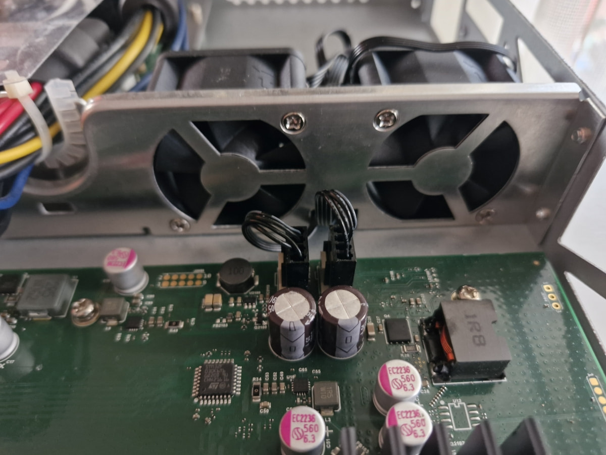

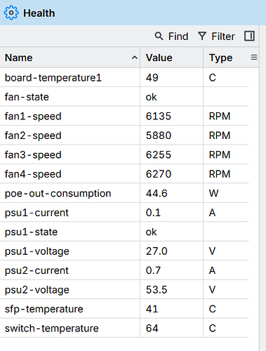

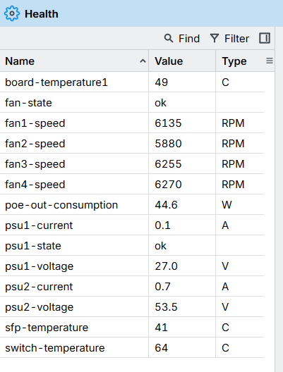

Once done, the PWM-fans work correctly, the pinout seems the be the standard, RPM is shown in ROS (Health).
I will monitor how the temperature will develop.
1 and 2 are the ones on the left and 3-4 are the ones on the right in this image:
https://www.servethehome.com/wp-content/uploads/2020/04/MikroTik-CRS354-48P-4S2QRM-Internal-Overview.jpg
Right?
Fan 1 + 2 are one the left, Fan 3 +4 on the right (serve-the-home-photo).
Stock-Fans 1 +2 (blow air out):
Stock-Fans 3 +4 (ingest air):
Replacement 1+2:
Replacement 3+4:

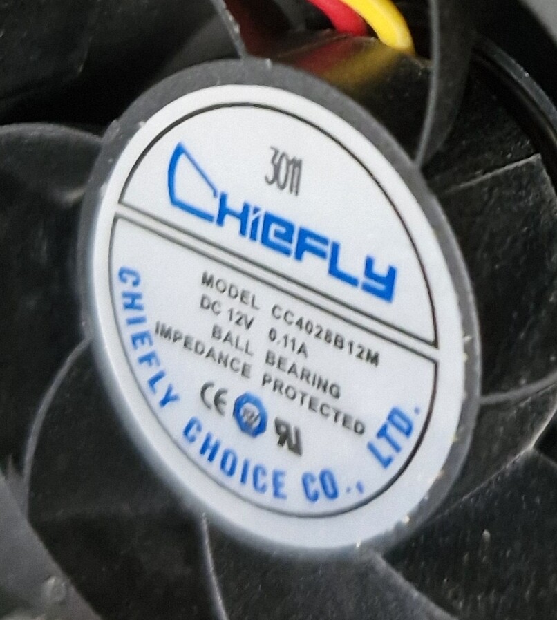

Stock model:
Temperature (left stock, right Arctics):
Health witht the Arctics (fan2 is a bit slowers, but was also slower witht the stock-fan):
