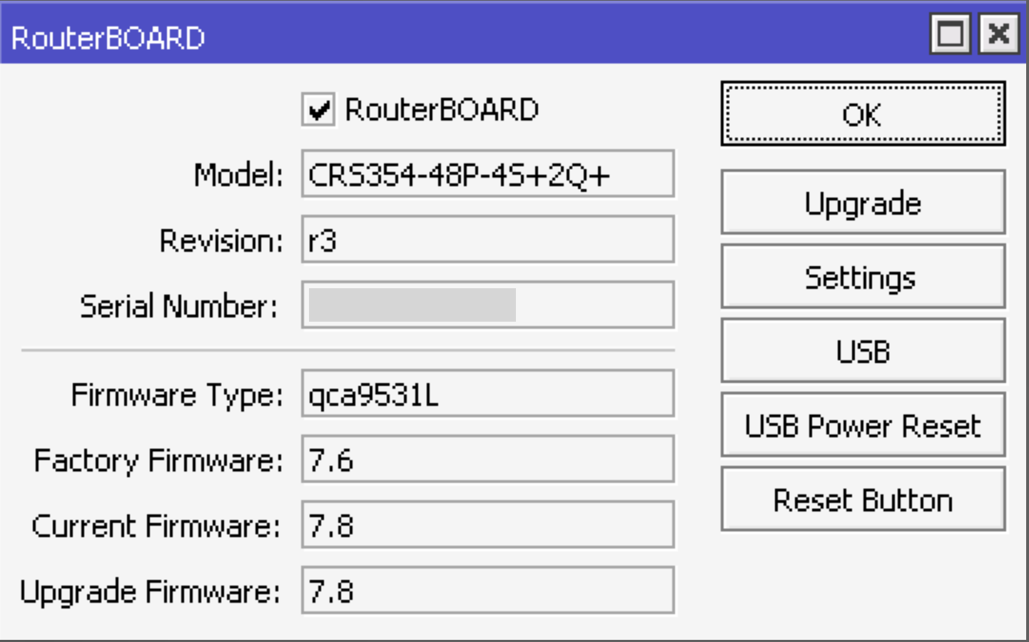

In our latest procurement of these switches I noticed that one of them had the “revision 3” designation on it. We had been using r1 and r2 in the field which are the problematic ones so I’m wondering what’s new with the “r3” hardware. Of course Mikrotik will never share details on this. It has factory firmware in the v7 range now instead of the v6.
Response from support regarding r3 of this switch is:
“Revision 3 comes with larger flash storage - 32MB.”
