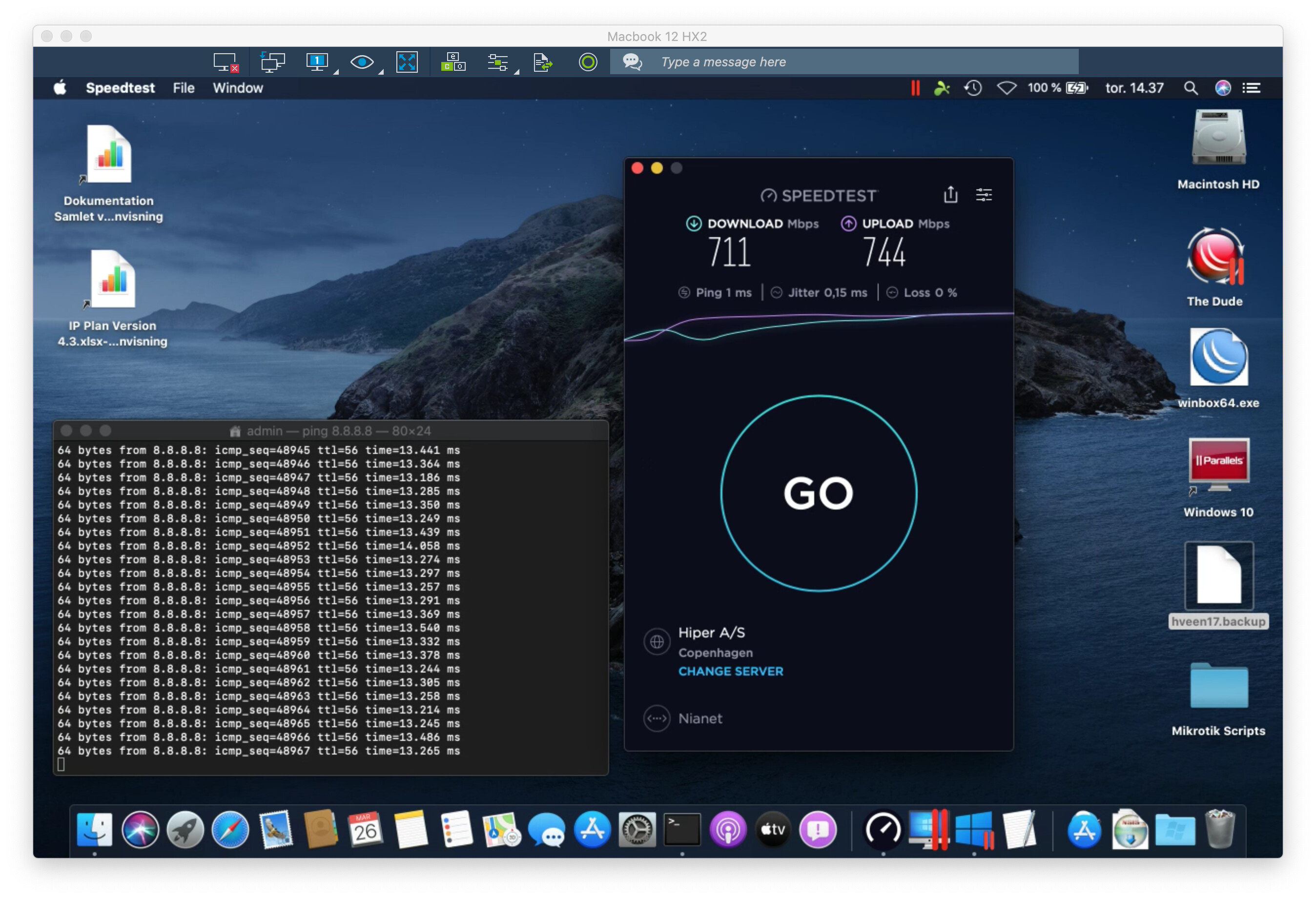

Hi All, is anyone experiencing the same issue
when testing we only get around 800/800 on gigabit ports
it looks like the same issues, as when the crs326 first came out, it couldn’t do gigabit either, not before after many beta releases?
why on earth does the new crs354 suffer the same problem, is it because its a MIPSBE processor, rather than the ARM Processor on the CRS326
please fix this soon, because I just bought 20 x CRS354 switches to implement, but for now can’t use them, because they don’t offer full gigabit connectivity on ether net ports?
sincerely
Carsten Larsen
Denmark
Please describe in more detail how did you test the throughput on the switch - share some basic network diagram, the actual test results (as a screenshot or terminal output) and the CRS354 configuration export.
Hi Edpa
the basic network is this
CRS1036-8G-2S+ (10G internet connection) ---------> CRS317 Core Switch ---------> CRS354 (user switch)
All the devices are connected together by DAC Cables. and are linking with 10G
I have MacBook connected directly to the CRS354 and by doing a speedtest, I only reach about 711/744Mbps
See Screenshot
If I connect the MacBook to the following setup
CRS1036-8G-2S+ (10G internet connection) ---------> CRS317 Core Switch ---------> CRS326 (user switch)
I get speedtest of 940/940Mbps, this I reproduced several times, and I have about 300 x CRS326 in my network, so I´m well wandered in the switch.
I have about 6000 users, which all are connected to the CRS326 Switched, and no-one has trouble reaching speeds of around 950/950Mbps
The setup is the same, the only difference is the end user switch being either the CRS354 or the CRS326
here is the export of the CRS354, and I will post one for the CRS326 so compare

Perhaps you can find the missing piece, to why the CRS354 won’t give full gigabit.
I remember when the CRS326 came out, it had the exact same problem, which was resolved after a few months, but I didn’t expect the CRS354 to have the same issues
I have just purchased 15 X CRS354 that I need to put into use very soon, but I can’t as they are right now, because my users will complain of only getting 700´ish Mbps
If you need further info, please let me know, I have the setup running in my lab, so I can test further
Sincerely Carsten Larsen
Configuration wise, cannot see any issues on the CRS354 device. I would only recommend enabling RSTP or MSTP, but this should not affect the throughput if there is no active loop. But on the CRS326 device, don’t the ingress and egress rate properties limit the throughput?
Have you checked if there are any Ethernet errors on CRS354 or CRS317 devices?
Please run the tests again using the same client on CRS326 and CRS354 devices and create supout.rif files after the tests are finished on both devices. Please report this and attach the supout.rif files on https://help.mikrotik.com/servicedesk/
you are right the egress rate and ingress rate is enabled on the crs326, I will disable it for the test, and send you both support files after the speedtest is done
there are no ethernet errors on either switches
will send you the files in 10 minutes
sincerely
Carsten
files sent
any update on when the ethernet ports will give full gigabit speed?, I need to start using these switches on around the 15 of may?
Edgar p wrote
"On the CRS354 there seems to be appearing some tx-drops on the 1Gbps Ethernet interface that might affect the TCP download throughput. The counter increases every time when the device cannot send out packet to a certain interface due to congestion. The congestion can appear when a switch receives more traffic than it can actually transmit (e.g. sending traffic from a higher rate to lowe rate interface: 10Gbps → 1Gbps). At first, the switch tries to queue some packets, but the device has only a certain amount of resources to save these packets. Then switch will treat the congestion with dropped packet until some frames get transmitted and the queue frees some space for new packets.
We will investigate the problem further in our labs and try to improve the behavior, but I cannot provide any ETA yet.
Best regards,
Edgars P."
Hi edgar, do you think its possible to fix this before the 15 of may, I understand that you are very busy due to corona and all, but really need to start using these 15 x CRS354 switches by that date
Sincerely
Carsten Larsen
Hi @blackbox100 (Carsten), what does the tool you are using (speedtest) do test: the WAN speed or LAN speed?
Because, I think it’s connecting to some servers in the Internet (it says Hiper A/S, Copenhagen), is that correct?
I think such performance measurements one should perform inside the LAN and with a tool like iperf2, IMO.
it test wan speed to the internet, but Edgar (from MikroTik) has confirmed that the problem exists, when I do the same test on the CRES326 I get full gigabit speed, but not on the CRS354 with the same config
It works now, the latest beta fixed it
Then you should mark the issue as solved → check the menu item that says “accept this as the solution” or something like that.
You should mark as solved the actual post that shows the solution, so others can eaily find it without reading all the posts…
