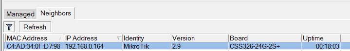

Alas - the switch is still shipping with V2.9 (11-25-19), and the default IP address is not 192.168.88.1. After reviewing the MT Wiki, one graphic indicated that it tries DHCP for the first 10 seconds, then falls back to the 88.1. Wrong; its half the story. You can let the switch sit powered up for a long time, then connect it to a network with DHCP, and it will still grab an address. Maybe an isolated direct connection into it from a PC might allow access at 88.1 after 10 seconds - I did not try this.
While their free Winbox admin app cannot be used to administer the switch, one poster above indicated Winbox could be used to see what the DHCP assignment is quickly. This works. Open Winbox and use the Neighbors tab (not the Managed tab) to view the MAC addresses of all the MT devices in your network. IP address will be there.
