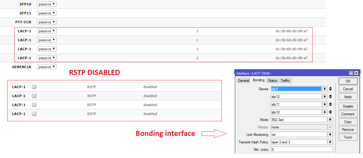

Here I have working with 1.25gb gbics in LAG image attached, I hope it helps!
