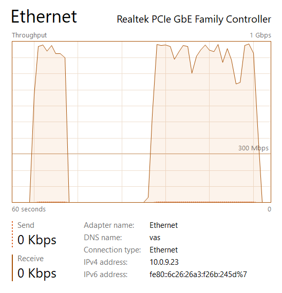

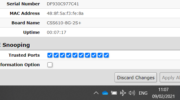

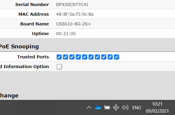

I take back what I said about RC25 being fine, I am getting hourly reboots of the switch on the hour with full outage.
Started a transfer just before reboot for testing, you can see where the switch cuts out
Disappointing :frowning:

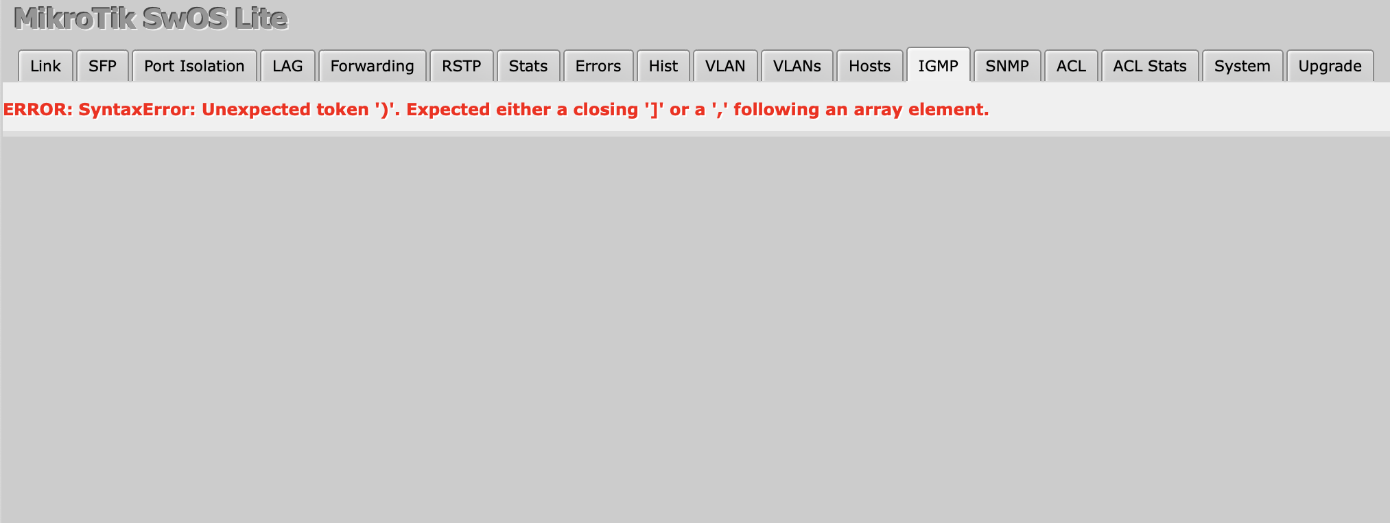

2.13rc25 breaks IGMP Snooping for me…
When IGMP Snooping is enabled in System and web interface is on the IGMP tab, multicast members are shown for a few seconds before the page is replaced with an error message in red text:

Have your device actually rebooted? Because it might be that Uptime is only bugged.
I noticed it back in RC2 with Zabbix SNMP scan. Yet I did not recall losing connection at all, i had my always plugged via the switch.
I used switched as it is in current situation usable - as dumb switch.
See my comments a little higher up. I think watchdog is broken. Our was rebooting exactly every hour as well. It was a true reboot with 15 seconds of packet loss through the switch each time it rebooted.
