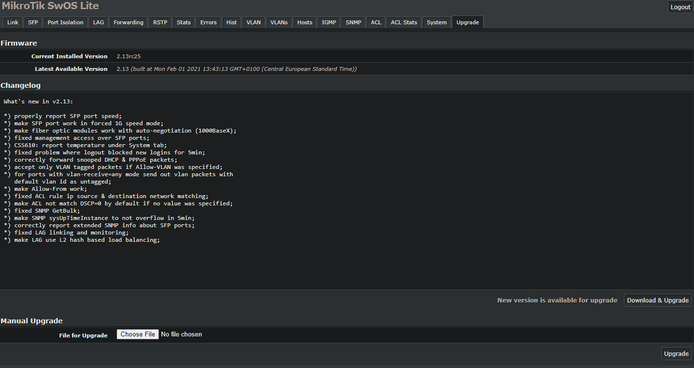

Has 2.13 been pulled off? It is not finding it for me anymore.
Also as per screenshot it was dated as 1st feb, but there is nothing about 2.13 on MikroTik download page.
Can anybody confirm if this is still available?
I was able to just install it again through the switch’s web user interface. Seemed to install fine.
The web UI appears to be downloading http://upgrade.mikrotik.com/swoslite/css610g/swos-css610g-2.13.bin
The check for the latest firmware looks for the contents of http://upgrade.mikrotik.com/swoslite/css610g/LATEST
The changelog is the contents of http://upgrade.mikrotik.com/swoslite/css610g/CHANGELOG
Thanks, that did it,…my CSS610 always reported and error, unable to check for updates.
Only when I first clicked the link, suddenly the update option appeared.
Anyone sees this?
