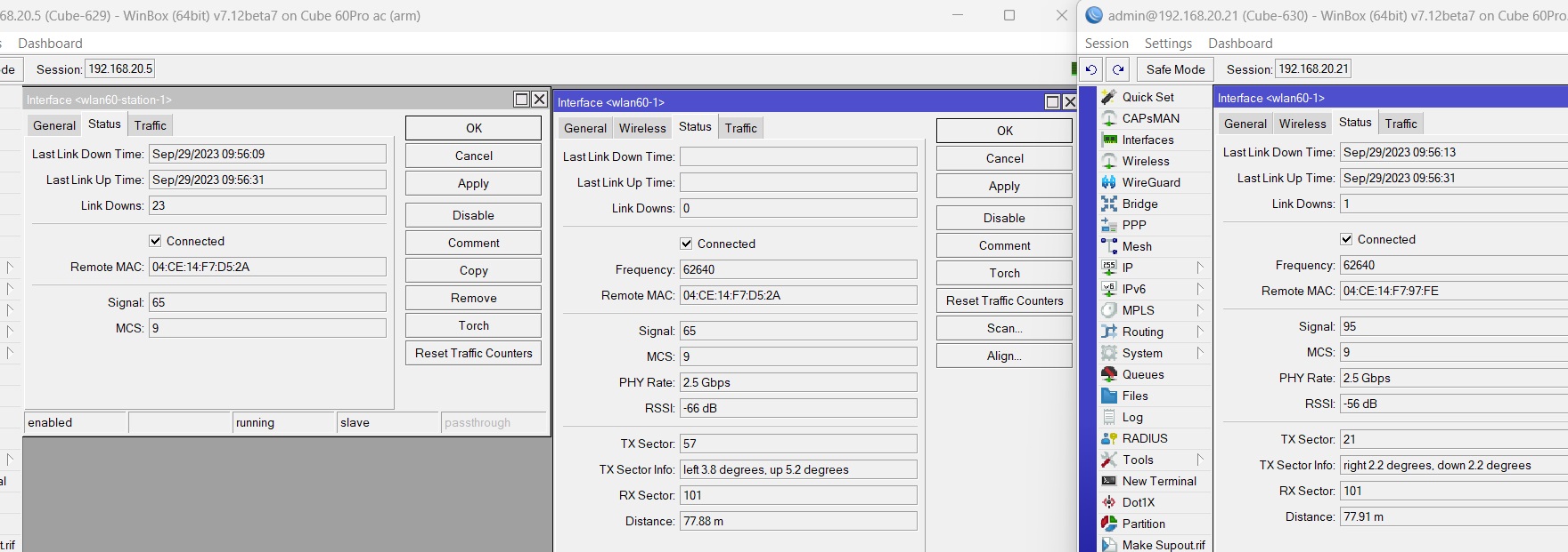

Cube alignment acceptable?
Would you be satisfied with this connection?
Can anyone give me their analysis of the quality of this link?
It says it’s off by 5 degrees. How did you align them? At 78m you should be in the -40’s or higher, not -60’s.
Personally, I place my phone against the face of the Cube and center it on the remote end.

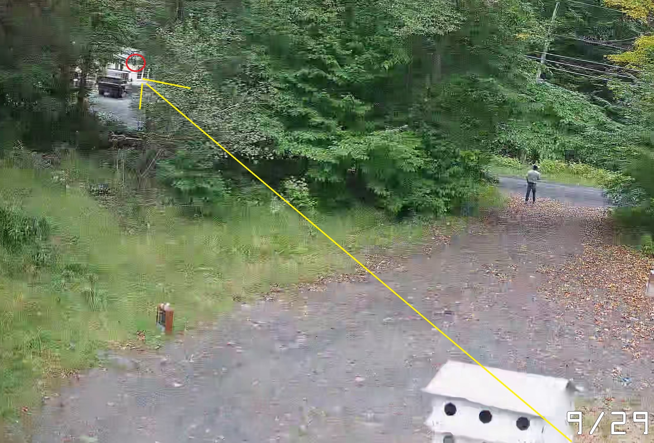

Here’s a follow up.
Cut a clear path through the trees (hopefully with enough to clear the freznal zone) and got a more stable connection (no ups and down) and (I think) as faster one also. There is definitely room for improvement if I’m willing to lose more branches.
