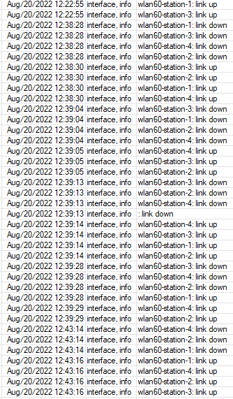

We have a new setup of about 15 CubeSA 60Pro AC access points with Cube 60Pro AC client radios and since we installed them, we’re getting frequent drops on all 60Ghz clients. We have a simple setup with bonding (for 5Ghz failover) and can’t see why this is happening. Any suggestions on where to look? Both AP and CPE are running 7.4.1.
I’ve tried turning on wireless / info or debug in the logs and aren’t getting anything. The client signal strenghts are in the 80’s and 90’s with an MCS of 8.

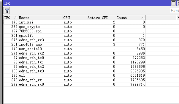

I met this problem also , Both AP and client running 6.49.6,I saw large amount of IRQ related with ether net interface. Hope this will be useful to solve this.

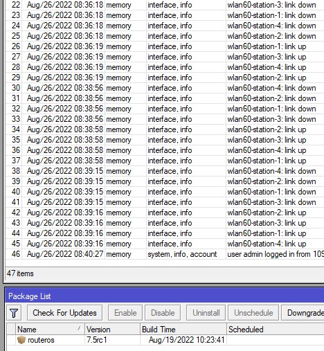

The same problem with 7.5rc1. Mikrotik are you working on it?

Client’s Up&Down are closely related with Ether interface’s IRQ , and It seemed that there is no IRQ load Balance , CPU#0 will response All those IRQ, then, CPU #0 reached 100% usage, then, flapping occurred. and I think IRQ Load Balance and IRQ Merge will reduce flapping.
And I also feel puzzled abut why not Ethernet hardware forwarding does not work.
