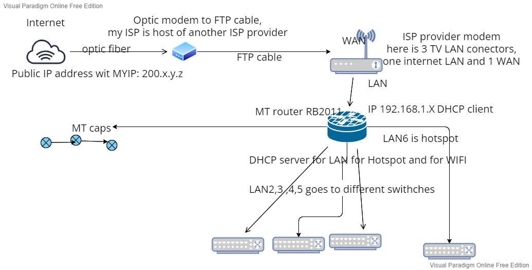

Diagram network attaced.

I talk to my ISP provider and they told me that what they can do is to make a bridge on their modem, and then I establish the PPPOE tunnel to their modem and I will have internet and all the stuff on my MT router.
so my questin is what will then happen and how to configure properli the IPTV, what you suggest making VLANS or any IPTV will flow over Mikrotik router and swithes to the SETTOP box without any problem cause on my network and swithes, will I have a problems maybe?
