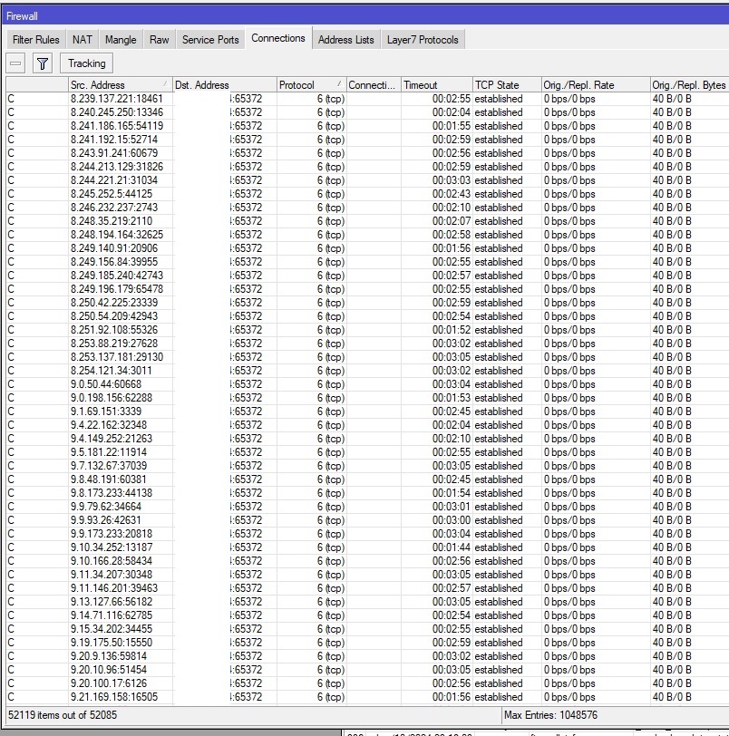

I only see different IPs:ports and a form of blacklist that after a while fills the memory and crashes the router.

One issue I see is that port tcp/65372 is exposed. If you are seeing a lot of established connections, it means these are available to the whole world. Could you limit them in the filter instead? Another change you can make is to more aggressively terminate the unacked connections (IP → Firewall → Connections → Tracking → TCP Unacked Timeout). By default, this is 5 minutes, which means that the connection will be kept in the half-open state, waiting for the final ACK, for 5 minutes. Consider diminishing this to 1 minute or even 30 seconds.
Looking at the addresses in the screenshot, this seems to be randomly generated, some are assigned to Level3, IBM, … Unluckily these big guys are attacking you.

I have also question related to dynamic allowed lists. On my dstnat rule I have dynamic list of allowed IPs (duration cca 1 minute), to allow only verified IPs in. After this list expires, connection is still established (which is OK for me), but I dont understand why. I thought dstnat happens in prerouting phase and until packets are send to forwad or input phase, there are no fast forward, connection state or filtering rules applied..

Do I understand well, that it reestablishes nat entry in case of some timeoutst? That turning it off it makes it more strict for evalluating what is new connection (must have syn flag and does not match any existing connection)? Are there any negative consequences for turning this off (real life experience)? Thanks!
Actually this is what I am trying to do. One drop all rule in end of filtering, but still allowing internet to work via rules before that. On UDP I succeded, but not on TCP. Currently I am dropping everything except established connections (when i start to drop, internet from inside is not working). But that ddos was established connection…And I dont understand why, it is not going through nat to any server behind, because only verified IPs are dstnated.

My comments:
The fasttrack, invalid, and established in the chain=forward should come on top, then the rules for the new packets.
The rule with the connection-nat-state=dstnat accepts everything coming from any network, as long as a dstnat was done. Consider changing it to reflect the NAT (source, real destination, real port).

You have an empty port, not sure how the router reacts to that.
add action=accept chain=forward dst-port="" protocol=tcp src-port=853
Similar situation a bit further, empty connection-nat-state.
add action=drop chain=forward connection-nat-state="" connection-state=\
    invalid,related,new,untracked
Not really sure what the empty address-list is or what it does but it could be that it never matches.

The destination you obscured on the screenshot, destination port 65372, is it the IP of the Mikrotik itself or one of the NAT addresses?
The chain=input rulebase misses all the bits for fasttrack, established, invalid, related and so forth, and doesn’t have a global drop for the WAN.
This drops anything coming directly at the router from the identified DDoSers. Likely redundant with the ACL in the raw prerouting, but could catch stuff if the other one doesn’t work. I readded the default rules, plus a few ones for accepting local stuff, your remote management addresses and block everything else.
add action=drop chain=input comment="Cybervermin B-Gone" in-interface-list=WAN src-address-list=ddos-attackers

This is my public IP, so address of mikrotik router. Thanks a lot for your comments!
Then the last rule of the input chain I suggested will take care of it.
Btw, are things getting better?
you will avoid null connections, established connections with 0 replied byte. Have the LOOSE CONNTRACK disabled.
I have it enabled. But advice was to disable it. So I am quite confused now :slight_smile:
