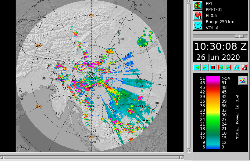

Weather radars are quite beasts actually. They transmit in short bursts and receive most of time (e.g. 1ms transmission, 999ms reception) and their antennae are really narrow-beam (norm is 1° in both directions). Their average Tx power is only a few watts, but then do the math: in those short time slots when transmitting their Tx power is a few kilowatts, “amplified” with antenna gain of around 45 dBi … beaming into sh..tty wifi receiver.
As many of you could guess, the influence is not one-way (radars affecting wifi APs), stray wifi APs affect weather radar measurements as well. A weather radar image, showing the scale of the problem:
Image shows measurements of otherwise “benign” atmosphere without any significant rain fall, so usually reflections would be blue at most. Blue mostly indicates clouds (without ground-reaching precipitation), green and up indicates actual rain drops (or snow fall) and red and purple colours indicate heavy hail.
The interfering AP is there for years and is identified to lay SE from radar (cross in the centre of the circle) way beyond nominal radar range (as noted on the picture radar range is nominally 250km and is drawn as change of gray background to darker shade).
