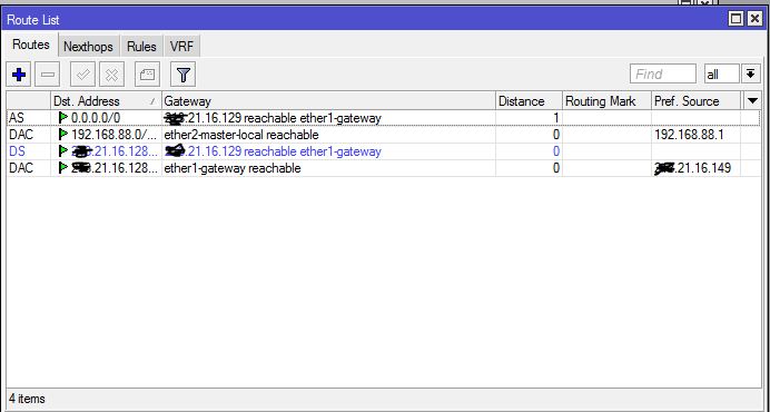

If I’m setting /ip router add dst-address=0.0.0.0/0 gateway=ether1-gateway as suggested by CameronE, it says ‘reachable’, but I’m losing internet connectivity. The DHCP option add-default-route is set. So, any ideas, what’s wrong in my configuration above? Thanks!
How interesting, are you able to publish your router’s config? You can use the ‘export’ command on the cli to dump it.
Will do once I get home!
