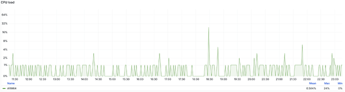

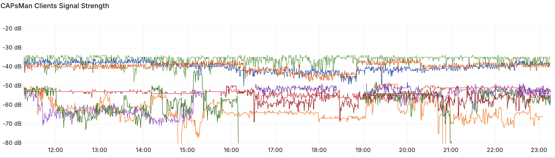

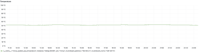

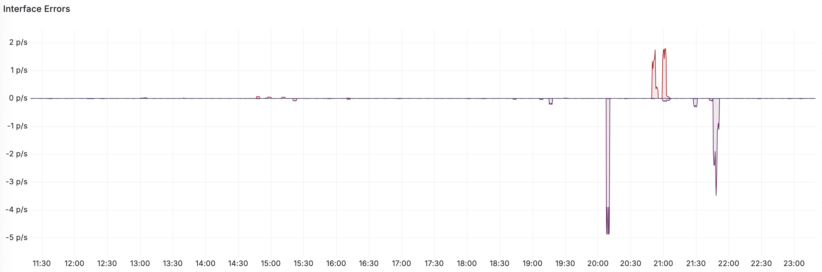

If there’s a chance setting up something like GitHub - akpw/mktxp-stack: MKTXP Exporter monitoring stack , then it will give more insights and help with troubleshooting, for example this is what I see with my AX^3 wireless clients in the past 12hr:
And the other useful to troubleshooting graphs:
