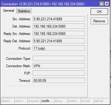

i have make some test, and probability i have found de my config Bug.
(1.JPG) on the second Router i Recive the Packet with the real Public IP.
My Problem(Question) is , to tell the Router to Respons over the Roter 192.168.169.2 and not to exit over the default gateway…
how i can set this?

If you forward port to completely different remote network with own internet connection, you need hairpin srcnat rule, because it makes it work. Without it, replies would be sent using the remote connection and it would not work.
It might be possible even without srcnat, if you find a different way how to send replies back via VPN. For that, you’d need to mark connections coming from VPN on remote router, add another routing table with default route to VPN and then mark routing for reply packets to send them to VPN. Then you’d have to do the same on server, mark connections from VPN, add routing table with remote router as default gateway and set routing for reply packets to use it. If you have Fail2ban there, it’s probably some Linux, so it should be possible. You could recognize packets from VPN by their source MAC address (the one of remote router’s LAN interface).
