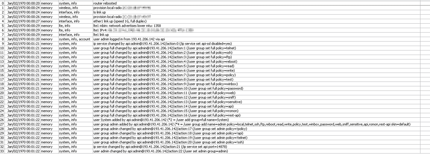

I performed netinstall (without default config) on my device (Chateau LTE12) to latest ROS version (7.16) because I had some trouble doing it with regular upgrade procedure due to my fault (power failure while upgrade process was in progress).
After netinstall is done and rebooting I connected to ROS using Winbox and changed password but I was not unable to open Terminal (Terminal - not permitted (9)) because I wanted to apply my configuration from export. This raised suspicion and I looked into logs:
Device got hacked approx 1 minute after connected to internet, created backdoor System user and changed api port.
Since Chateau LTE12 is lte device it connects to internet immediately and in short period until password is set without default configuration device is vulnerable since I have public IP over lte, but I wonder how some scanner is such fast to detect unprotected device while password is not set…
I performed 2 netinstalls so far hoping I will be faster than scanner, but no luck, now I will go with some small configuration script which disables lte interface for avoiding internet connection until configuration is fully imported.

Curious because how fast it got hacked and hoping that ROS is not calling somwhere which triggers scanner and hacking over unprotected API.
Isn’t there a (removable) SIM card? :confused:
Nah there are lots of hosts that are focused on scanning such things. I got caught by the same thing and ALSO with api but on a fresh CHR on VPS.
It’s actually your fault that you netinstall with WAN/modem link up, eject it until your config is reapplied and device is secure.
P.S.: still propose MT to disable api/rest stuff in defconf to prevent such things. Those API hacks seem to be common.
defconf has firewall rules in place that dont allow api access from WAN. But basically I agree; API should be disabled by default in defconf.

Netinstall was performed without config, no defconf or any config to avoid conflicts with exported config. Complex configs are not applicable for import automatically with netinstall, but I solved later with simple config script: /interface lte disable lte1.

Connecting to the internet prior to having at least the requisite firewall rules in place is a fools game, unless one is into gambling.

Well after thinking why I was doing it like that in the past and not bothering much, it was because my MNO always assigned me WAN IP behind CGNAT over network provided APN which protects you from direct access from internet and in that short period until new password is set and firewall rules applied I wasn’t concerned, but it seems they changed that and I’m now getting assigned public IP for which I was needed to setup custom APN in the past. Now I definitely needs to be more careful when performing clean netinstall to apply config script for disabling lte interface after first boot.
