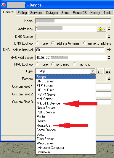

I installed dude 6.44.6 on test system because I want to move from 4.0beta3. I decided to redraw all maps from scratch, and I seen something confusing. Under device type I can choose “RouterOS” and “Mikrotik Device”
for MikroTik Device:

Device types shown come from a table you have control over. Click the box with three dots (“…”) to the right of the field you show, this will open up all defined device types. Examine the ones you have questions about, see what differences there are and what defaults they have. (Some of the values shown in your image do not come by default with the Dude, so someone at your site defined them locally; I can’t know how they are setup.)
On my copy of the Dude, I use this field to define what model of equipment each is. All the MikroTik models are defined equivalently except for their pictures. So it would not matter to the operation of the Dude which model I chose, except that the photo would be incorrect. You could have this sort of duplicate definition as well, you would have to check.
