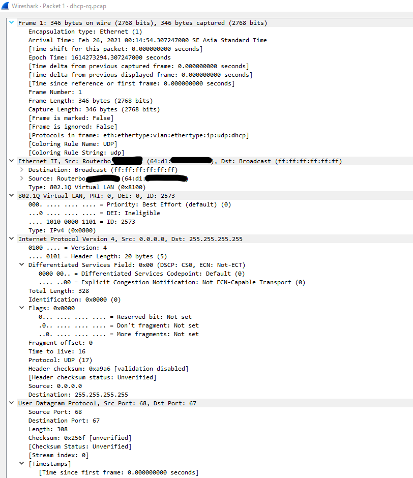

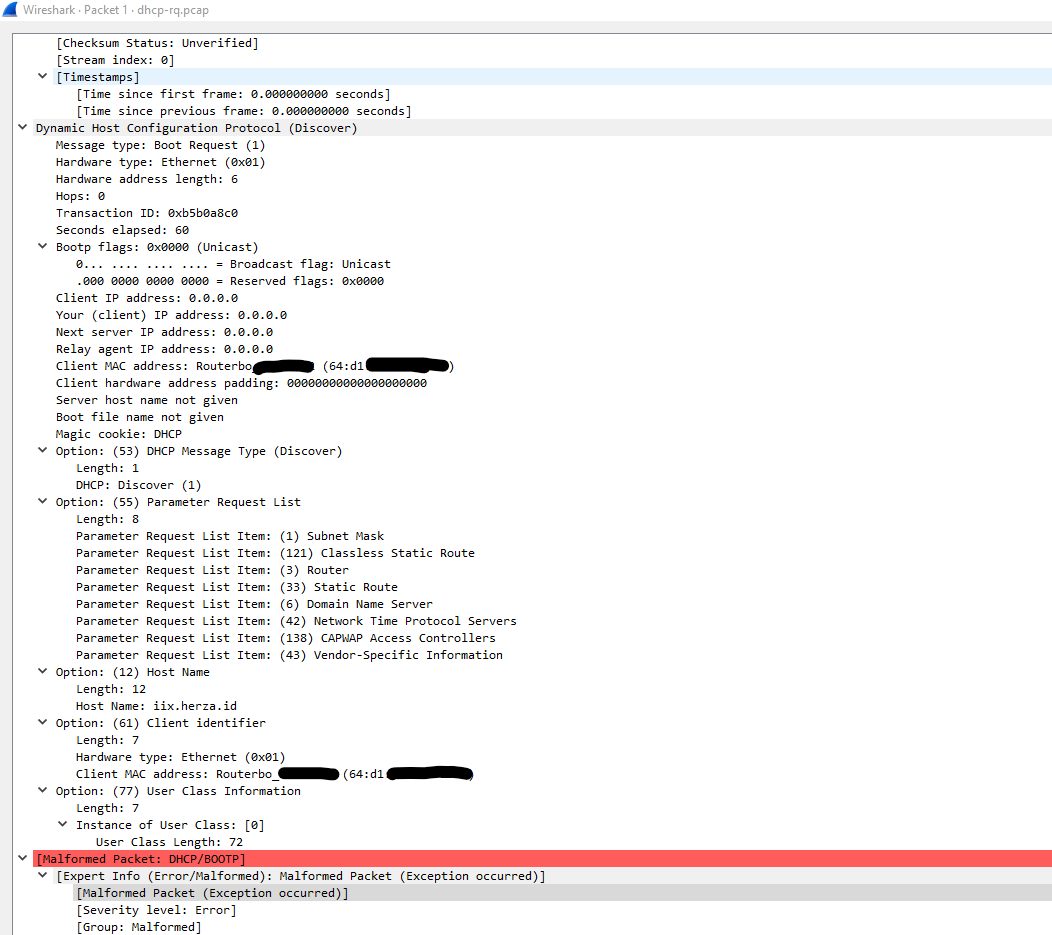

The data I collect looks like this… Any advice?
No. Time Source Destination Protocol Length Info
1 0.000000 0.0.0.0 255.255.255.255 DHCP 346 DHCP Discover - Transaction ID 0xb5b0a8c0[Malformed Packet]
Frame 1: 346 bytes on wire (2768 bits), 346 bytes captured (2768 bits)
Ethernet II, Src: Routerbo_XX:XX:XX (64:d1:XX:XX:XX:XX), Dst: Broadcast (ff:ff:ff:ff:ff:ff)
802.1Q Virtual LAN, PRI: 0, DEI: 0, ID: 2573
Internet Protocol Version 4, Src: 0.0.0.0, Dst: 255.255.255.255
User Datagram Protocol, Src Port: 68, Dst Port: 67
Dynamic Host Configuration Protocol (Discover)
[Malformed Packet: DHCP/BOOTP]

Since the transaction ID is shown, dissection of the DHCP part must have succeeded at least partially although a malformed packet is reported, so open any of these packets in Wireshark (GUI) rather than tshark, unfold the DHCP dissection and find the client-id.
No dhcp-relay configured on the machine? If not, is the sfp-sfpplus1 bridged with any other interfaces (physical or virtual)?
Sorry I really dont have any idea reading the output from this wireshark data. So I attached for your review. Hope you can help…
Defenately not… No DHCP Relay configure in any of our router and we dont have bridged configure in our CCR.
On the second screenshot, closer to the bottom, there is Option 61 - Client identifier. It says “Hardware type: ethernet, Client MAC address: Routerbo…”. Plus slightly above, there is Option 55 - Parameter Request List, which contains item 138 - CAPWAP Access Controllers, and Option 121 - Classless Static Route. This combination of requested items is quite distinctive, albeit not completely unique, for DHCP requests sent by Mikrotik devices.
So if the MAC address in this item exactly matches the one on the Ethernet II → Source row close to the top of the first screenshot (you have hidden both), the DHCP Discover packets are sent by this Mikrotik - since there is no bridge and no DHCP relay, there is no way how they could come from outside.

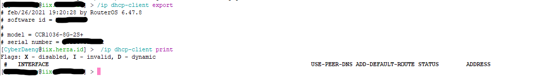

So what does /ip dhcp-client export and /ip dhcp-client print on that CCR show?
Could it be that you normally use Winbox or WebFig with “skins” (or someone experimented with them in the past at least) and access to DHCP client configuration is hidden on the GUIs for the user name you use to log in?
And what is the RouterOS version? If the skin assumption is wrong, the /ip dhcp-client section of configuration is empty, and the RouterOS is reasonably up-to-date, I’d recommend to create supout.rif and open a support ticket with Mikrotik, as it would indicate a difference between the actual configuration and the one presented to the administrator.
Nothing shows up when I run those command. Thank you very much for advice… I will try to open ticket to support.

PROBLEM SOLVED. Enabling “DETECT INTERNET” in Interface is causing the issue. You only need to Disable it…
That’s why posting complete configuration exports is always recommended.
The “detect internet” function causes many different surprises, but as I find nothing useful in it (like other users on this forum), I constantly forget about its existence. So if I could spot it in the configuration export, I’d probably suggest to switch it off, but it didn’t come to my mind without that impulse.
The same issue was reported by my IX too…
