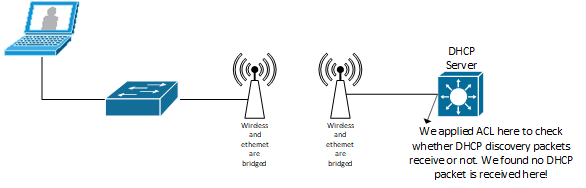

We have a setup like this:
Client------switch-------BridgeMikrotikRadio1<----------->BridgeMikrotikRadio2--------DHCPServer(Switch)
But when client discover DHCP can’t find it! We tried to check it with an ACL on switch to determine if discovery packet are received or not. We found switch doesn’t receive any discovery packet !
We have similar configuration with copper between another switch and DHCP Server Switch and it’s working just fine. So its configuration looks okay and working.
I think there is a problem with radios in path which don’t pass discovery packets! I checked their configuration, no DHCP server , client and relay is configured there .
Any idea or similar problem there?

There is a Switch (dhcp server) behind AP radio. Client is connected to SU.
When we capture ingress traffic on switch connected to AP, it doesn’t show any Dhcp descovery pcket! It means radios are not passing this pcket across each other.

I attached a simple drawing of scenario.
Note:
all devices are in VLAN1. If we can solve the problem, then we go for VLANs and DHCP server should assign IPs across vlans . SO the links which are connected to both switches are in Trunk mode. Radios must pass traffic for any kind of vlans. They should also work exaccccccccccctly like a fiber or copper media. withouuuuuuuuuut any data manipulation! ( L2 and L3 information like intervlan routing and intravlan switching) . They should also answer their management traffic.
