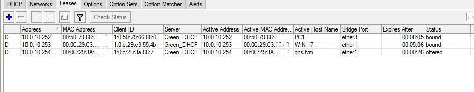

Here is a screenshot of the lease window too:
As you can see, all the leases are for the green vlan, the first twos as expected, but I didn’t understand where the last one comes from, even though the status is on “offered”.
