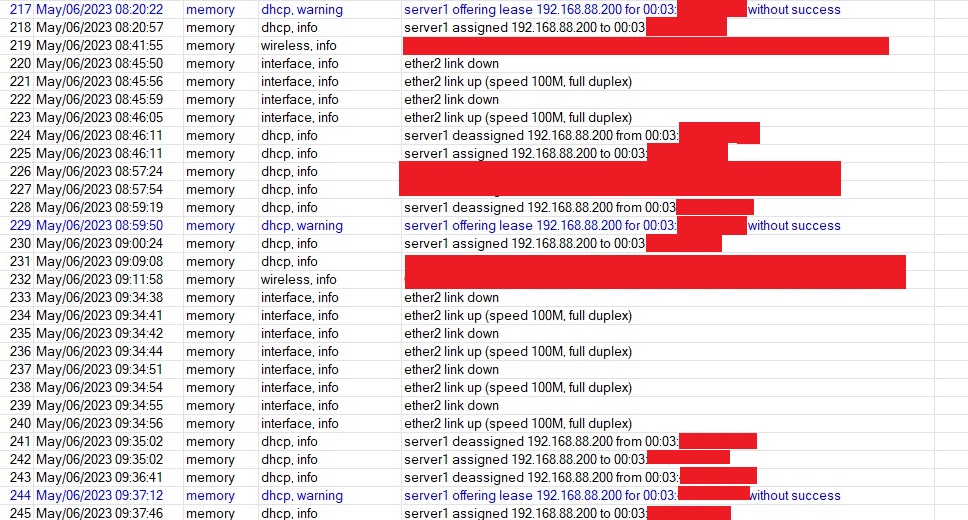

Hello, I’m writing here to solve a problem I have on an interface to which an alarm system is connected.
The base is RBD52G-5HacD2HnD (hap ac2), and through the winbox side logs I notice these problems:
  1. server1 offering IP lease for MAC without success
  2. ether2 link down/up (where the alarm interface is connected)
  3. server1 deassigned IP from MAC
  4. server1 assigned IP from MAC
    by IP I mean static ip that assigns to the interface with that MAC address
    Alarm interface side, through the logs, at the same known time:
  5. IP network failure
  6. dhcp failed
    I add that it is not a physical problem as I also changed the patch getting the same error. the dhcp server assigns other addresses statically to different clients and all of these I have not found any kind of problem in the logs.
If you need further details of my mikrotik configuration I am at your disposal. What I can tell you is: alarm side ethernet interface get ip automatically via dhcp, router side dhcp lease on the mac address of the alarm.
Where is it that I’m wrong? How can I fix? Thanks to anyone who can help me

I was actually a bit too general.
  1. the “server1” is the dhcp server that offers a static ip to the “MAC” interface of the alarm
  2. ethernet2 to which this alarm interface is physically connected has no physical cable problems. Probably, but this is only a guess, the interface of the alarm not having some kind of response from the router, carries out a disabling and a re-enabling of its own interface. Up & Down is not caused by the router in short
    3/4) from the attached mikrotik log, I see that at a certain point the IP assigned by DHCP is deassigned, I don’t understand why. Sometimes after deassignment the dhcp server reassigns it, other times not by displaying the : without success
    for controls:
  • the IP address is not already assigned to other devices. In addition, the dhcp dynamically has a range pool from 100 to 199. 200 is part of the static addresses
  • the alarm has a dynamic IP ethernet interface configuration. The router through its MAC address (and it is always the same) assigns it the IP address I defined in 200
  • when the interface is up, I can communicate until the connection drops, therefore a communication in periods of time that are not very defined and clear
  • there are no other DHCP servers in the network, it’s at the home level with about ten clients
  • the connection between the alarm and hap ac2 is physical, with a few meters long ethernet cable patch, and is physically perfect (already tried and tested also with other cables). There are no repeaters between them
  • on the bridge there are all the ethernet interfaces plus the wlan ones (ether1 is the WAN, all the other LANs, public INTERFACE and IP configuration)
Isn’t it just for the ether2 interface (alarm) that I have to configure a particular dhcp lease? Anyway, thanks for the help and replies
