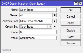

I did now create a “Generic Matcher” as told here: https://help.mikrotik.com/docs/display/ROS/DHCP#DHCP-Genericmatcher

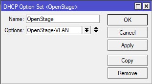

This references to an “Option Set”:

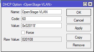

This references to the real “Option”:
I calculated the Value of 0x0201’8’ as told here:
http://forum.mikrotik.com/t/dhcp-option-help/65722/1
and here: https://wiki.mikrotik.com/wiki/Manual:IP/DHCP_Server#Properties_3
0x = hex
02 = code 2
01 = VID = single digit → “8” in my case
‘8’ = decimal number

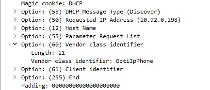

The phoine itself asks for the Option 60:

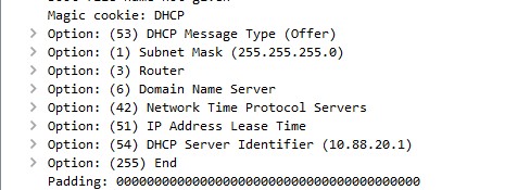

Does it work? OF COURSE NOT:
MT does not give out the Option 60?
I cant figure out why? Its so overly complicated with MT always…
Mikrotik is not complicated, it is difficult to understand the garbage (HiPtah/OpenScape/etc), which is not very widespread…
0107
5369656d656e73 - Siemens
0204
00000065 - vlan id 110
031a
DHCP Option 43: 0x01075369656d656e73020400000065031a - Siemens on vlan id 110
Option 60 does`t support.
Or:
0107
0204
00000004 - vlan id 110
031a
73646c703a2f2f39332e3132322e3131342e39363a3138343433 - sdlp://93.122.114.96:18443
ff
