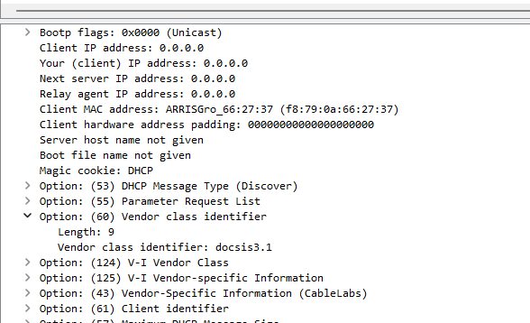

Is it possible to configure code 67 within an option set using option matcher? I’ve observed that unless I specify the boot file name under network settings, the boot file doesn’t get applied, while other settings do. I’m seeking advice on how to effectively designate a boot file using either an option matcher or a MAC static lease, as both methods don’t seem to be functioning as expected. Any guidance or suggestions would be greatly appreciated. Thank you.

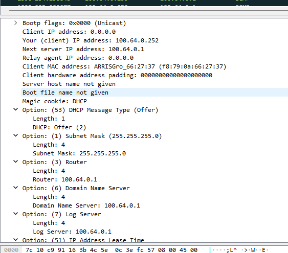

if I don’t set 20.bin the dhcp server network doesn’t send the boot file name
as seen below (edited)
dhcp offer

if that was the case 20.bin would in in the DHCP offer but it isn’t.
going forward assume 20.bin for everything. I did attempt to change it to 20mb.bin but no change.
