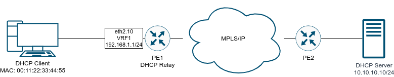

We are having trouble migrating our services from ROSv6 to ROSv7 because we are unable to get the DHCP relay service to work within VRF.
Although this limitation existed in ROSv6, there was a workaround through mange firewall rules (http://forum.mikrotik.com/t/dhcp-relay-in-mpls-vrf/52570/1). However, we couldn’t get it to work on ROSv7. We suspect that changes to the VRF implementation in ROSv7 will prevent the workaround with mangle rules from working.
Has anyone been able to get the DHCP relay to work on VRF in ROSv7?

DHCPDISCOVER messages are sent to the DHCP server. Also, the DHCPOFFER messages sent by the DHCP server arrive at the DHCP Relay, however they do not seem to be processed and sent to the DHCP Client. I suspect that this is where the difference in behavior in ROSV7 and ROSv7 lies.
Below the relevant configuration:
/ip dhcp-relay
add dhcp-server=10.10.10.10 disabled=no interface=ether2.10 local-address=192.168.1.1 name=dhcp-relay
/ip vrf
add interfaces=ether2.10 name=VRF1
/ip firewall mangle
add action=mark-routing chain=output dst-address=10.10.10.10 dst-port=67 new-routing-mark=VRF1 protocol=udp
The network topology:
