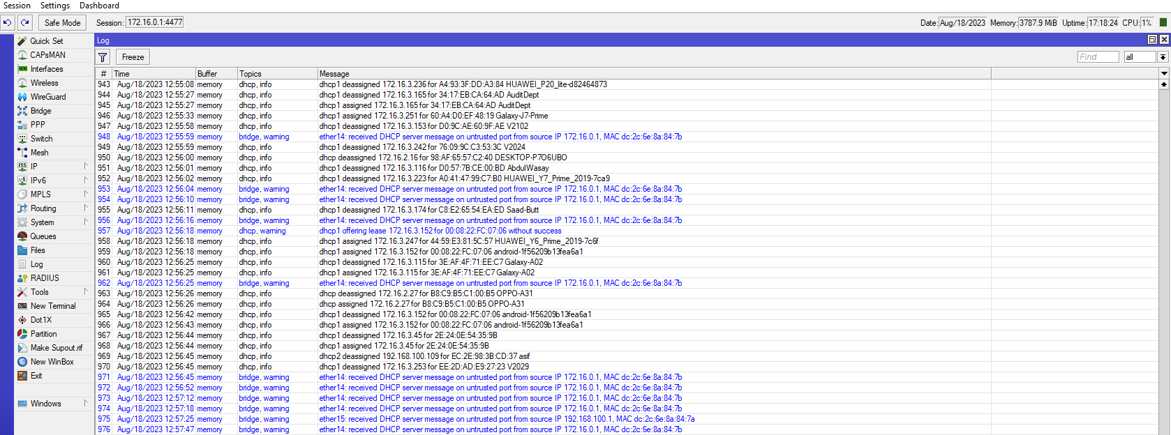

I have 2 DHCP servers on 2 different bridges.
Bridge_LAN1 has ether16 trusted=Yes &15 trusted=No and IP:172.16.0.1/16 DHCP
Bridge_LAN2 has ether13 trusted=Yes &14 trusted=No and IP:192.168.100.1/24 DHCP
and both ether14 & 15 are connected with wire for some purpose.
My desired work is working fine but how I can stop this error

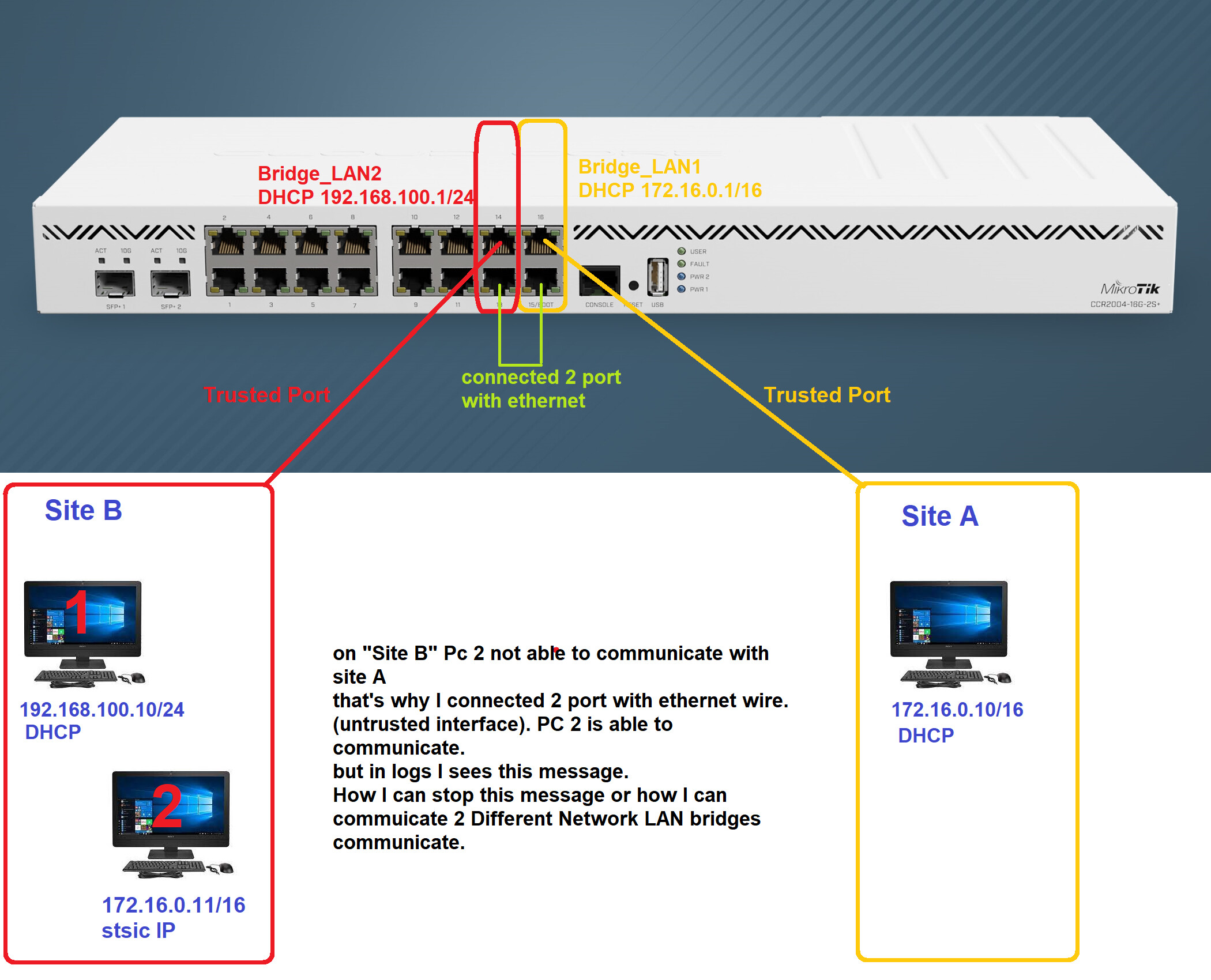

Could you explain the reason for connecting two ports on one router? Physical connection for virtual bridges? With NAT?
I didn’t use “untrusted” feature, but aren’t these warnings there because the servers are receiving packets from untrusted port? For me it looks like a missconfig somewhere which is routing too much throught this cable connection.
look in this attachment
or tell me how to route
Ok, so:
  1. What do you mean by site? Is there a switch or a router at the other side of cables on trusted ports?
  2. Are you using vlans or just the bridges?
on site a and site b i have 24 port switch.
not using vlan. Just using bridges
please help. me. in this regards
don’t want to go for vlan.
just want to resolve this with existing setup.
I just want to communicate 2 Lan network which is splict between 2 interface
I don’t have enough knowledge to help you with this in matter you want, sorry. Maybe someone else will.
It’s not a “communicate two LANs” thing because they are mixed (in site B there is a site A device). Probably you can open bridges to each other by adding some firewall rule/rules and get rid of that cable but it’ll open everything to each other.
Or you can open (accept) forward traffic from src address 172.16.0.11 in. Interface dst.address 172.16.0.0/16 throught ether14. As I said, I’m not familiar with untrusted bridge ports so I don’t know how it will behave - does it drop everything or only DHCP requests? If only requests, making a static IP locally (not a DHCP reservation on the server side) should do the work in this scenario.

There are so many issues here, let me see what I can start with.
  1. Get rid of the cable between ports 13 & 15 - that is NOT how to get two diverse networks to communicate! That is the router’s job.
  2. Since you are trying to run two networks from the CCR to site B, you have two choices. Either use VLANs to keep them apart or two cables to either two separate switches of if the un-named switches are smart enough, have the one switch operate as two virtual switches.
  3. Do you really need more than 250 addresses on your 172 network?
Export and post the config for the CCR so we’re not guessing.
