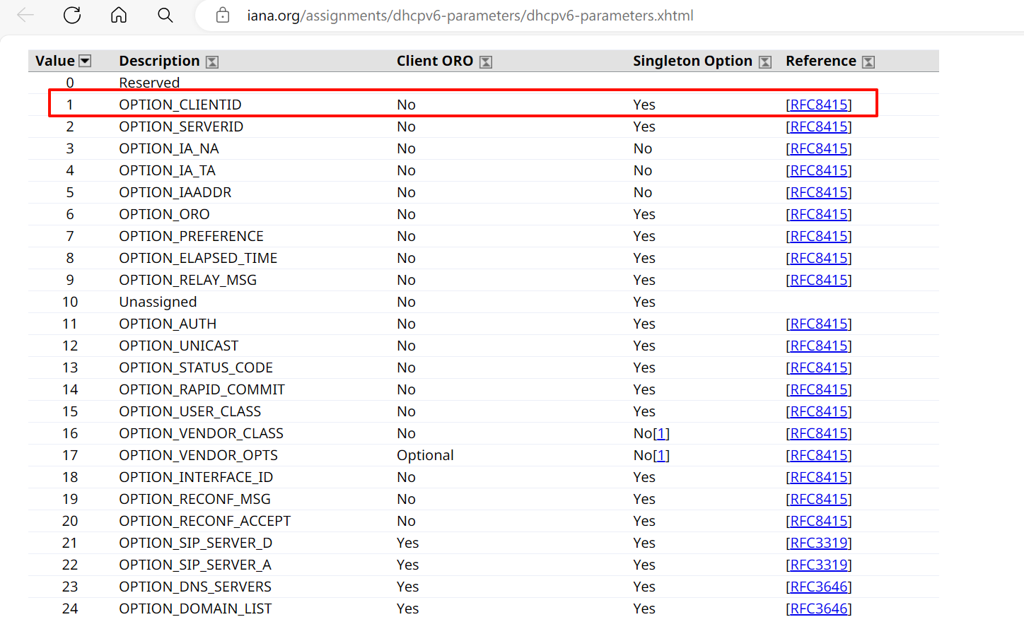

The IANA describes dhcpv6 client optinon:
code 1 is clientid
So:

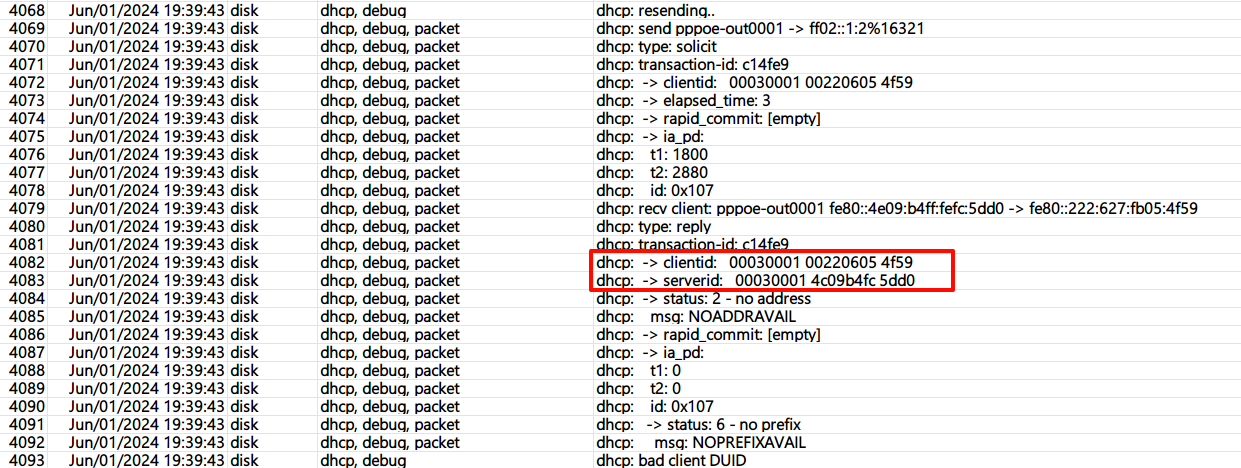

But the dhcpv6 client status in searching…
The debug log:
WHY??
From the log, I can see that the DUID I submitted has been modified successfully as I expected and is in compliance with the specified format.
But why does ROS report an error “bad client duid”??
