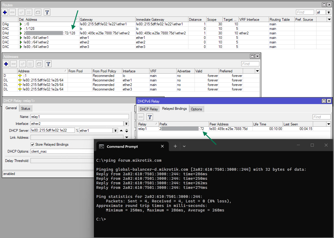

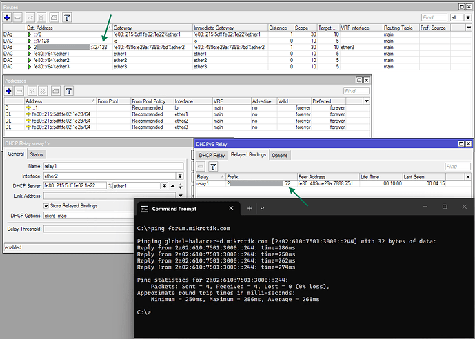

I cannot reproduce the issue, here is the full content of /ipv6 export on the test device configured as relay where everything works:
/ipv6 dhcp-relay
add dhcp-server=fe80::215:5dff:fe02:1e22%ether1 interface=ether2 name=relay1 store-relayed-bindings=yes
/ipv6 nd
set [ find default=yes ] interface=ether2 managed-address-configuration=yes other-configuration=yes
/ipv6 nd prefix
add interface=ether2 prefix=none
/ipv6 settings
set accept-router-advertisements=yes accept-router-advertisements-on=WAN
With ether1 being the interface to the upstream router where DHCPv6 server is running (and member of the WAN list), and ether2 is the LAN interface.
No manual addresses are added (only autogenerated link-local EUI64 addresses), also no manual static routes. The relay router correctly adds /128 routes and the clients behind the relay router (on its ether2) have IPv6 connectivity.

I've found the issue. The key is to set store-relayed-bindings to yes. Of course, to see the effect immediately, you'll need to remove the distributed dynamic addresses on the server side, and then request a new address on the client side.

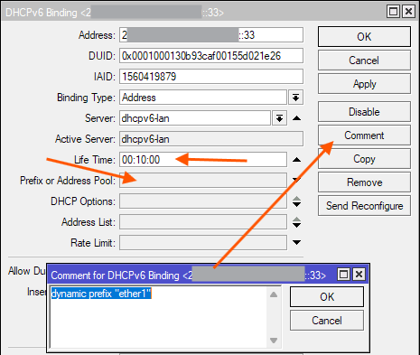

  • At this point, we can plug our client devices (that can use DHCPv6, which means Android devices are not supported) to the LAN port and they'll get dynamic ULA bindings. We'll make them static, just to get the right DUID and IAID. While doing so, we clear the Prefix or Address Pool field, shorten the lifetime, and give them the comment dynamic prefix "ether1". We can also change the prefix part of the assigned addresses to a:b:c:d so that they stand out.
    So after adding a bunch of static binding, we'll have the content that looks like this:
    /ipv6 dhcp-server binding
    add address=a:b:c:d::1000/128 comment="dynamic prefix \"ether1\"" \
        duid=0x0001xxxx ia-type=na iaid=123456 life-time=10m server=dhcpv6-lan
    add address=a:b:c:d::1001/128 comment="dynamic prefix \"ether1\"" \
        duid=0x0001xxxx ia-type=na iaid=234567 life-time=10m server=dhcpv6-lan
    add address=a:b:c:d::1002/128 comment="dynamic prefix \"ether1\"" \
        duid=0x0001xxxx ia-type=na iaid=345678 life-time=10m server=dhcpv6-lan
  • We now add matching /ipv6 nd proxy entries for those addresses (still with bogus prefix a:b:c:d) with the interface set to ether1 (the WAN interface):
    /ipv6 nd proxy
    add address=a:b:c:d::1000 comment="dynamic prefix \"ether1\"" interface=ether1
    add address=a:b:c:d::1001 comment="dynamic prefix \"ether1\"" interface=ether1
    add address=a:b:c:d::1002 comment="dynamic prefix \"ether1\"" interface=ether1
