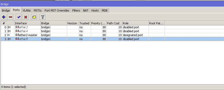

What I didn’t understand is the laptop was on 10.0.8.3 set fixed and port2/DHCP was 10.0.8.1. Anyhow, how do I remove port 5 from the bridge?
Okay, I found it…see pic below. Also, I believe I now understand what happened after reading here: Remove port from the default brige - #4 by Steveocee
The default bridge was what had the 10.0.8.0 network so when I disabled that, even though I had set network and DHCP on port 2, the bridge kept the Mac address.
