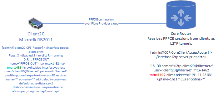

I have a client router initiating a pppoe session to my core router, I have set max mtu and max mru on both ends like this:
Core Router:

On the client side, it shows MRU as 1462, but on the Core router (the other end of the same connection) it shows MRU as 1492

Please see diagram below:
The question is: How can I force MRU value to be 1462 always, on both ends of the connection?
The setup is very unusual. If the client is a PPPoE one whilst the server is an L2TP one, and the fibre provider has no knowledge of usernames and passwords, it means they forward the PPP traffic between the PPPoE session terminated at their RAS and the L2TP session they open as clients towards your L2TP server. Since this is some proprietary implementation, anything may happen during this process, and some information may be lost. On the other hand, since the MTU at client side is 1462, you should never receive a larger payload packet than that from the client, even though the server shows a MRU of 1492.
Plus it may as well be a RouterOS bug. I’d have to see a sniff of the actual LCP exchange.
