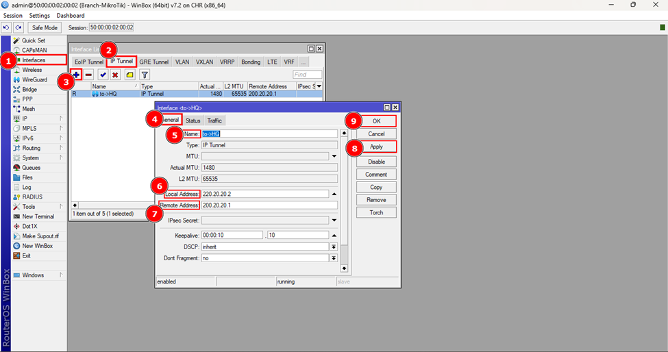

i use ipip tunnels from each side , i don’t see any passive options
That’s the case I have anticipated above - you’ve told RouterOS to create the IPsec configuration providing the IPsec encryption for the IPIP tunnel for you automatically, by setting ipsec-secret parameter of the row of /interface/ipip to a non-empty string. In particular, RouterOS creates items in /ip/ipsec branches peer, policy, and identity, using the default item in profile and a policy template in group default, which in turn refers to the default item proposal.
So on the central site, for each IPIP tunnel, you have to create a copy of the corresponding peer, give it another name, and create a copy of the policy and identity and link them to that added peer. Once you do that, you can set the ipsec-secret parameter of teh corresponding row of /interface/ipip to an empty string, which will remove the dynamically created items and keep only their “manually configured” copies in place, taking over their role. And then you can set the passive parameter of the peer item to yes, finally reaching the goal of the exercise.
