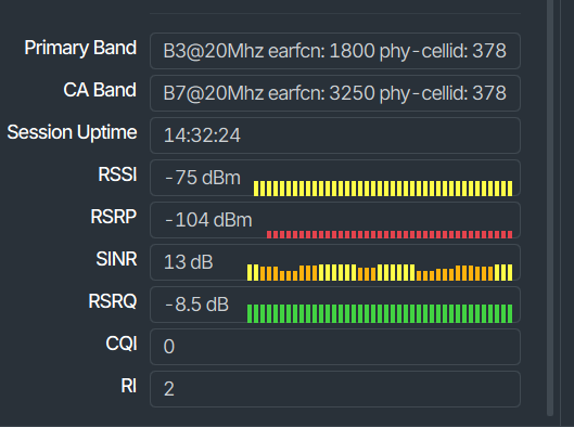

Thank you for your help. Are these the stats you want?
Connecting via wireless, but happy to try cable
RSRP is quite borderline. SINR is okay-ish. RSRQ as seen is good.
Does the b350 also provide LTE cellular stats? If yes, maybe the b350 connected to different bands/cells. Or did 3CA instead of 2CA. Or has better antennas. We can't know from here.

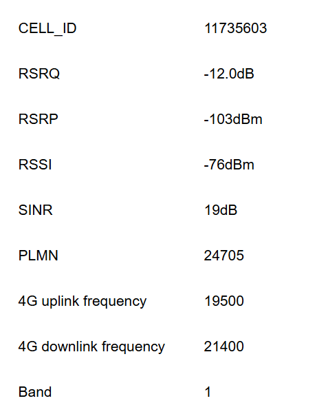

Soyealink stats:
(Sorry, I can't resist . . . )
So, you would say that the performance of this setup "Bites"? :rofl:
sinr 19db is much better. rsrp still bad. rsrq is meh. but the main difference is band 1 vs 3.
Try "band=1,7". So the modem can't use b3. And see how that works out.
