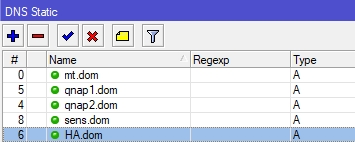

But what about the DNS names in my local DNS zone for other devices that do not have a configured mDNS name? I registered them in Mikrotik and can contact them by this name. They are transmitted via DHCP. Moreover, if I turn off the Bonjour service on QNAP, then I get the opportunity to ping/contact him by the name that I assigned to him on Mikrotik. That is, they are also supplied via DHCP. But I lose the ability to contact by mDNS name. Although on a regular Ubuntu I can simultaneously access/ping both by name from the domain zone of the Ubuntu DNS server and by the mDNS name.
That’s exactly what I did. Added entries on Mikrotik like: qnap.dom, sens1.dom, sens2.dom
