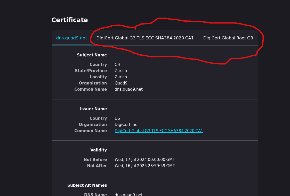

In order for MikroTik to perform certificate verification of the Quad9 DNS over HTTPS domain, we need to download and import the DigiCert Global Root CA certificate.
2.1 Download the certificate to your MikroTik router:
/tool/fetch mode=https url="https://support.quad9.net/hc/en-us/article_attachments/4618235579021/digicert-root-ca.pem"
2.2 Import the certificate into the local certificate store. When prompted for a passphrase, just hit enter for no passphrase:
/certificate/import file-name=digicert-root-ca.pem

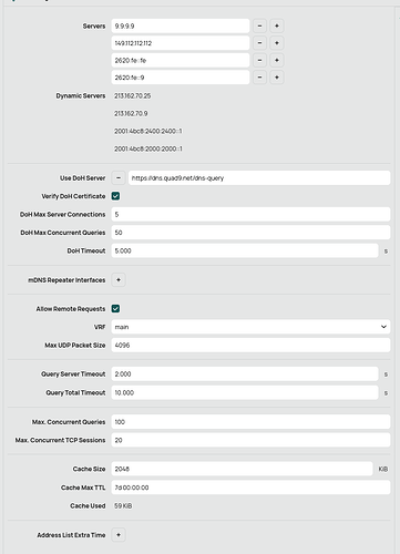

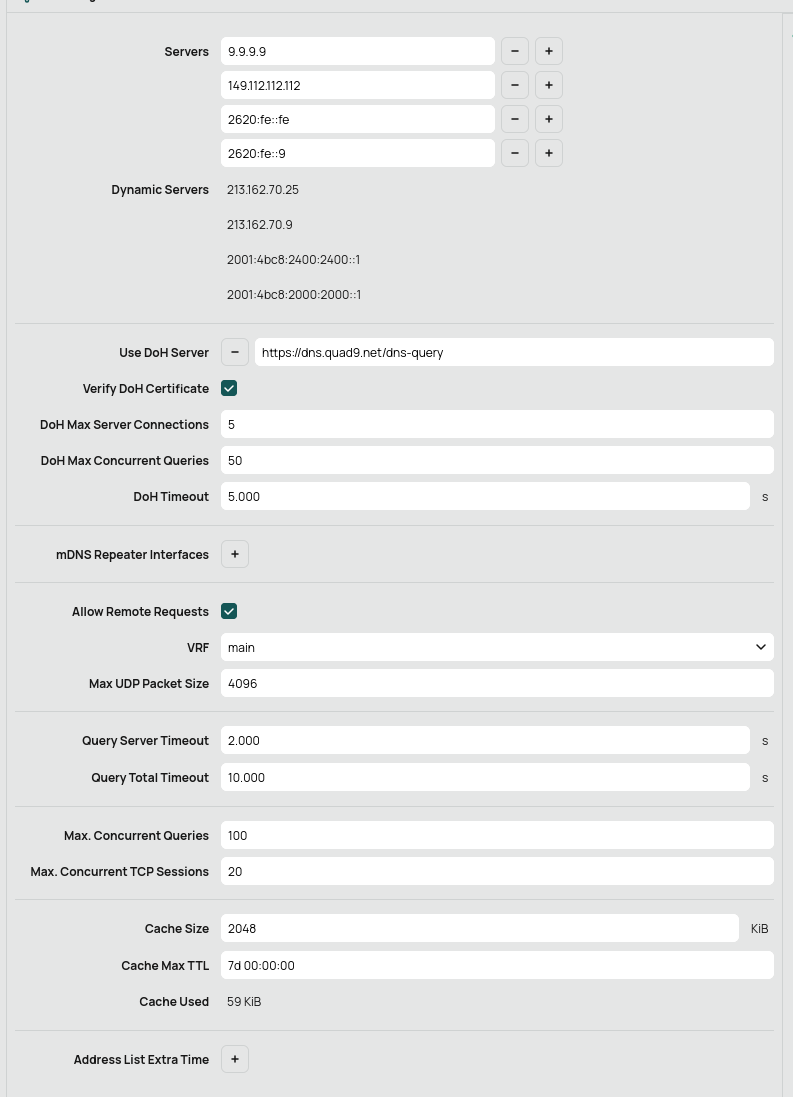

Log into Webfig (GUI), and navigate to IP → DNS on the left-side menu.
In the Servers field, set:
9.9.9.9
149.112.112.112
2620:fe::fe
2620:fe::9
Note: If your network does not have IPv6, which you can test here, then the IPv6 addresses should not be added, as it may result in a percentage of your DNS requests failing.
- Use DoH Server:
https://dns.quad9.net/dns-query
Verify DoH Certificate: Enabled
Allow Remote Requests: Enabled
Note: It’s recommended to prevent non-local IP address from querying the MikroTik router directly by creating the appropriate firewall rules. -
Click Apply at the top.
