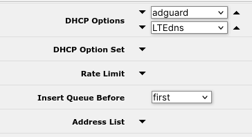

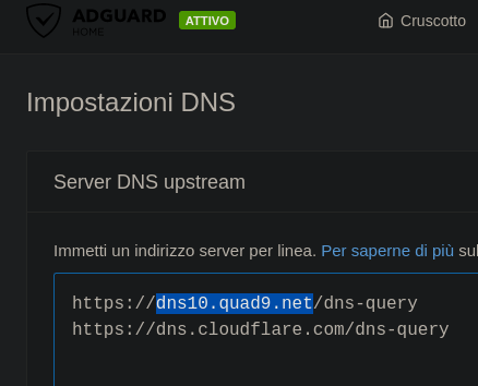

if you have a router with a lot of memory you can install docker on (or a raspberry) RoS 7.6 and following and run pihole or adguardhome and you can configure a lot of alternative dns I did that:
it is really all very simple.
But I still have some problem in ros ,from dhcp lease in fact I canât get it to switch between options automatically in case of a malfunction .
