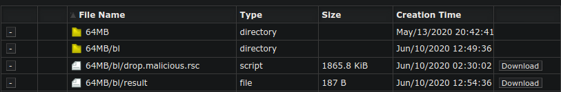

I set the scheduling every minute and had the results written on an external sacrificial MMC card, not to fry the tik flash.
When mentioning frying the flash, I had in mind the basic 6.47 which some users reports to generate thousands of sector writes without an apparent reason, not writing the fetched file to a flash - on my SOHO devices, files are stored in RAM unless you explicitly place them to flash.

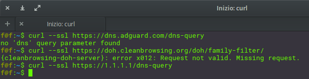

I don’t understand what you mean by ā€œworks wellā€ and ā€œyou always get an errorā€ in the same sentence, can you elaborate?
For those who have DoH configured with CloudFlare, does first test "ā€œSecure DNSā€ shows to you as a green?
https://www.cloudflare.com/ssl/encrypted-sni/
I thought the result file was written on mikrotik’s hdd, so I moved it to the external MMC.
The script always populates the mikrotik DNS cache even when the DOH cloudflare fails.
For the query response errors I thought about this .
Yes.
Have problem with that, I followed the nromis manuals, and I am unable to get First test green. Any recommendations? What should I have in DNS - Static, what should I have DHCP Server - Networks - DNS Servers?
Nothing if you use https://1.1.1.1/dns-query as DoH Server.
