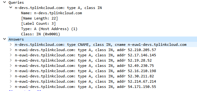

I had a look and the Kasa device DNS request has no caps in it
the failing one happens to be n-devs.tplinkcloud.com
approx. 432 seconds earlier, exactly the same request was resolved correctly
strangely it is the requests that should be passed through without MT involvement that are not working… when the MT is the proxy it works.
I can;t see any case change in either case
