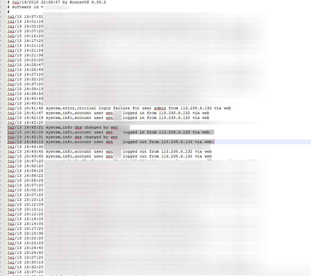

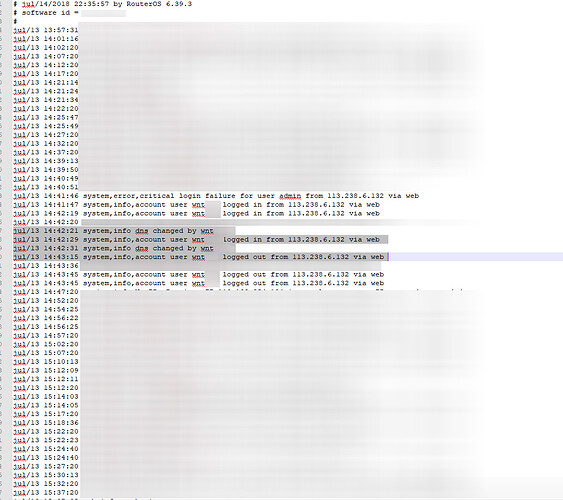

dam! i thought i'm the only one. currently running v6.39.3 x86 routerOS. it's the log i exported out, the day of the attack is yesterday. i noticed today, when someone complaining that DNS didn't work. i change my password now, let's see if i get another attack.

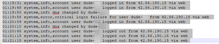

ok, i think, it is somehow connected to the dude. this time, i separated my user name. the one i use to login winbox, and the one the dude enter router. and yesterday, i got another attack from the dude username.
You are running vulnerable version, so no surprise that someone can change your settings when they can get all your usernames and passwords.
It was mentioned in this topic, upgrade, change passwords, add firewall…

Yes, i was actually expecting the second attack. i need to know if it is somehow connected to dude or not. i update the ROS today, let’s see if it is fixed.
Did you change all your passwords after update?
