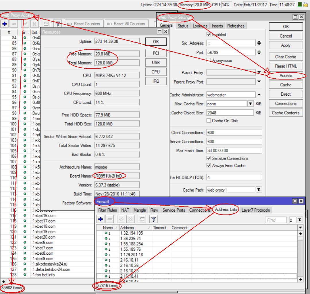

Transparent webproxy does this work for now, but can’t manage HTTPS connections (why?) and loads CPU up to 100%, so I want to reject blocked domains somewhen earlier, returning 127.0.0.1 for DNS requests to that ones.

Embedded web proxy always DOES this work with about 36K regexps (& about 38K IPs in firewall address list).
Of course, it eats RAM (we need to store all that strings at last), but why DNS records have to eat more RAM than webproxy records?
And IMHO DNS internal procedures are simplier than proxy due to protocol design.

I wonder how webproxy can manage 37K regexp’s? The same content, the same strings and much more work to filter them every request.
What’s wrong with DNS server there?
