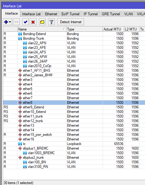

Besides upgrading to 7.21 (still on 7.14) is there maybe something I can do to improve efficiency of my setup? Maybe with how I am using the copper ports? I am not using any hardware bridging at the moment.
Everything connected to copper is 1G ethernet and everything on the SFP+ ports is 10G fiber.

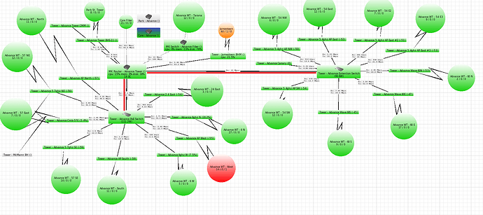

So what I have is the CCR2004 is connected with 10G fiber to my uplink path through leased 10G link back to my core (no ports drops shown on core interface). The other 10G link connects to a CRS305 where I have 2 Tarana BNs connected also via 10G fiber.
I then have 2 Netonix POE switches that power various APs. All APs are connected to switches at 1G. Switches are connected back the CCR2004 via 2x1G interfaces setup in an 802.3ab Bonding LAG (red lines).
I then have a couple of wireless backhauls connected to CCR2004 at 1G. One is a wireless backup for the tower fiber feed the other is a wireless feed to another tower.
Everthing is routed on the CCR2004 where I am using the vlans for Router-on-a-stick purposes where each AP is in a vlan on the Netonix switch and then that Vlan interface on the router is the IP gateway/DHCP server for the subnet for that AP.

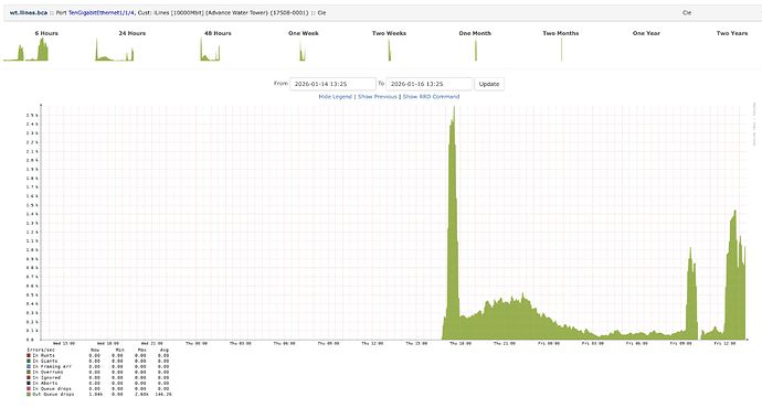

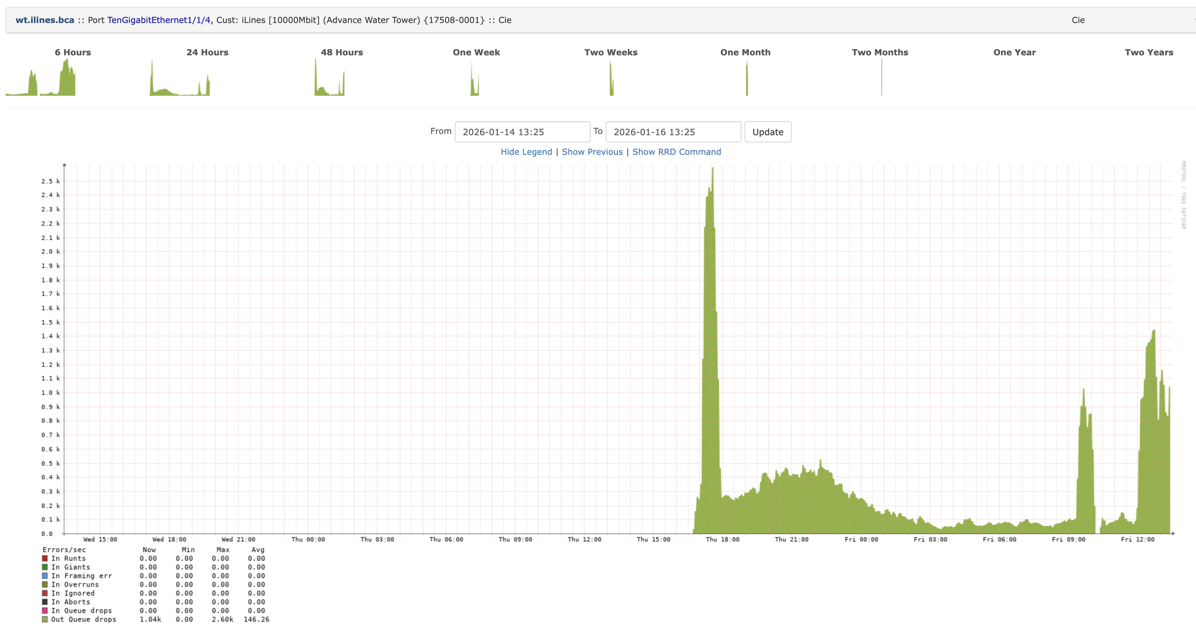

When I enable flow control on the 10G Uplink port all RX drops go away but my upstream provider’s (leased 10G transit link) cisco switch (router?) starts showing large amount of output drops while my router just shows TX pause frames. Again this is a 10G link to 10G link.
I'm seeing output drops, which happen when we try to send traffic faster than it’s being received on your end.
I'm also getting a noticeable amount of pause frames from your device, which usually means it’s getting congested and signaling that it can’t take traffic quickly enough.
