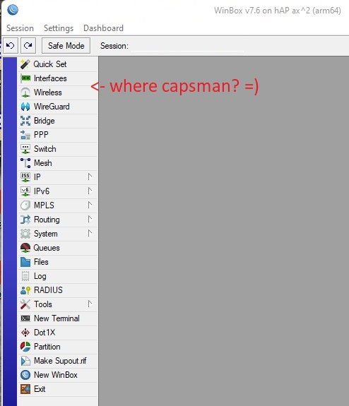

In version 7.7 beta 9, which I installed, capsman is available via the terminal, but is still missing from the interface.
http://forum.mikrotik.com/t/v7-7beta-testing-is-released/161807/86
The crucial part to understand “why not in menu?”
*) wifiwave2 - added initial CAPsMAN support (only compatible with wifiwave2 interfaces) (CLI only);
I admit, I was not attentive.
