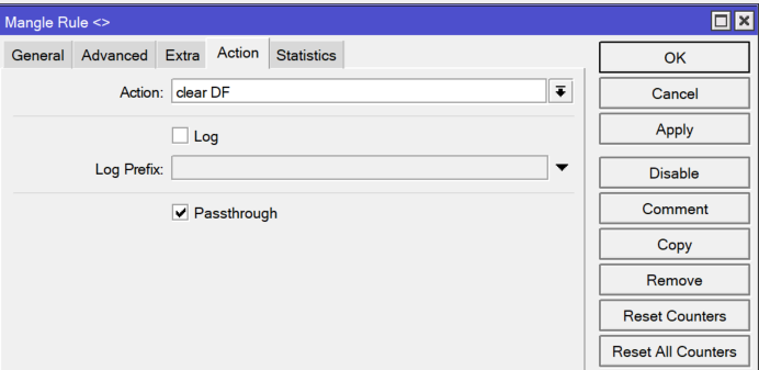

Although 12 years have passed, I will still write the notes, since I myself was looking for an answer.
Now in “ip firewall mangle” is among the action “action = clear-df”.
Here we go https://wiki.mikrotik.com/wiki/Manual%3AIP/Firewall/Mangle#Properties
Just attaching an image to show the feature in Winbox. This thread helped me figure it out.
Certain sites set the DF bit for SSL websites, and I believe we can use this mangle rule (at IP>Firewall>Mangle) to clear it and let the sites work through fragmentation. For traffic through a tunnel, you’ll want to set this as a forward rule.
If you want to test it using the Ping tool on the Mikrotik, you’ll have to add another rule for output. And of course you need to repeat this at both ends.
