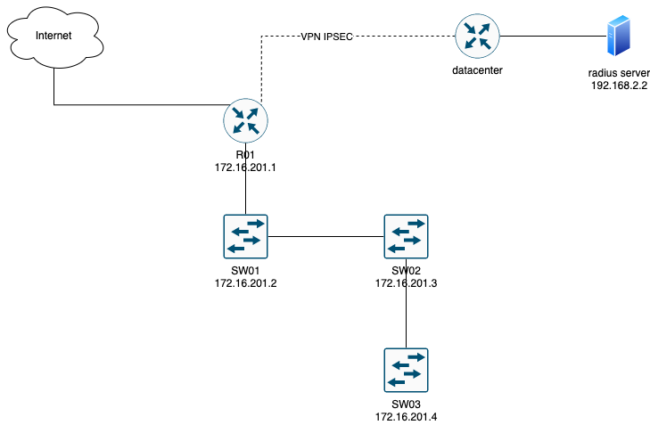

I’m trying to set up dot1x in an existing environment.
there is a mgmt network as shown in the picture and the switch can ping the radius server via vpn. is there a problem with me running the traffic through two other servers and a router in the way that makes it not work or what am i missing? tried to go after the wiki and read how others did but can’t find a solution.
Found something about BPDU cant be active.. ? can that be a problem on the other switches?..

When you have multiple networks, make sure the RADIUS client picks the proper source address for its queries.
You can explicitly configure that.
I have tried with and without to specify src adress on the radius no luck.

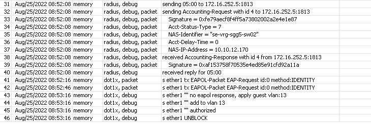

Im trying in another network. I get this error.. or TX error.
Help.
First lines are about “accounting”, not “authentication”. (There are multiple EAP methods in RADIUS. “Accounting” can be sent to other RADIUS server, than autenticator RADIUS)
Testing with NTRadPing ?
NAS IP (switch IP) must be in the NAS list of RADIUS server. Be aware of NAT changing addresses.
