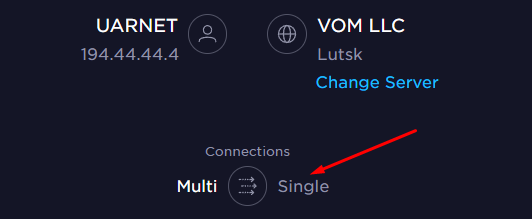

Speedtest use multiple connections for test, so i dont see something unusual at your screen. Try test with single connection
