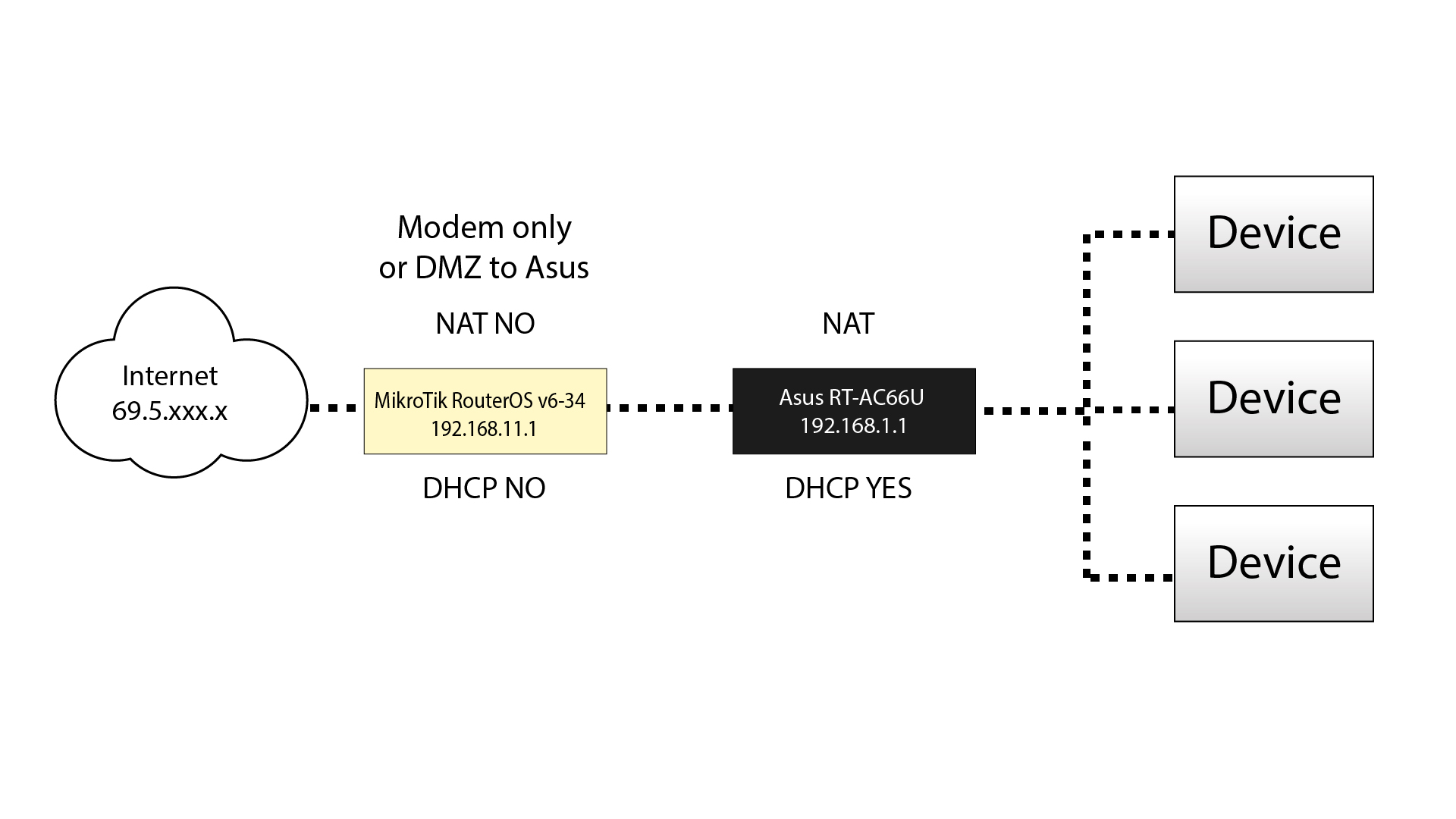

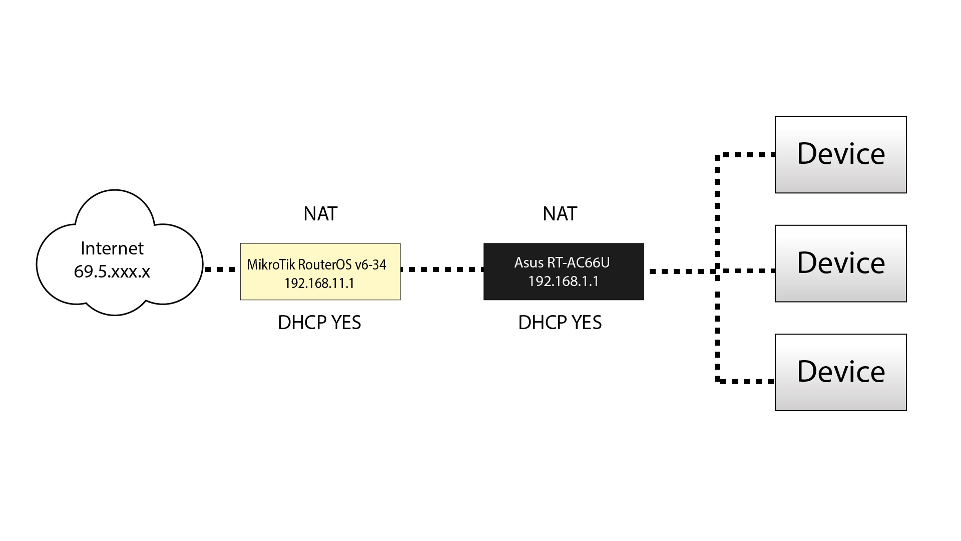

I found this forum and was trying to apply what I saw in it without success.
I have a dual Nat happening with a Mikro Tik V6-34 and a Asus RT-AC66U.
I am not as familiar with Mikro Tik. I’m looking to either disable the DHCP from the Mikro Tik
or place the Asus into a DMZ. I followed the Nat rules that were outlined in the forum,
replacing the IP addresses that I have. I kept disabling my internet so i disabled the rule.
I’ve included pictures below of what is happening and what I hope to achieve.
thank you for any help in advance
