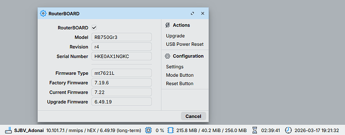

Now look at this image:
Interesting that the factory firmware is 7.19.6, and the command said I could install 7.13+ on v7 and 6.49.8+ on v6.
RouterOS was successfully downgraded to 6.49.19, but the firmware would not follow that downgrade.
Now with version 6.49.19, the command /system device-mode print only returns one line: mode: enterprise, and I no longer have access to that information about supported versions.
I just wanted to share this with you all, because apparently the rule that a downgrade cannot be done below the factory firmware is no longer an absolute truth.

Mikrotik always supported downgrading to a software version that was older but compatible with the device on a hardware level. Because the rb750gr3 has had no changes, it still runs v6 fine. It's still maintained, so there's nothing inherently bad in doing so. (But I'd prepare my script for v7 :slight_smile: )
Downgrades on many devices are restricted because of a hardware change, where proper drivers are simply not available in older versions. These are completely blocked.
The "allowed-versions" from device-mode is not about this. They are a restriction for the sake of security. This can be turned off in the device-mode, and it's controlled by the "install-any-version" flag.
All of this deals with the software version and not with the firmware version.
As @lurker888 wrote: screenshot is about firmware (the "UEFI" part) ... and I highly doubt that it will allow you to downgrade it (press "Upgrade" button and see yourself).
The device-mode is about ROS (the "OS" part") ... "factory-software" from /system/resource/print indicates (but seemingly not always enforced) the lowest ROS version, supported on certain device (really old devices don't have this info "burned in").
For me, this topic just has a clickbait title.
Downgrade from factory firmware 7.x to 6.49.x is possible!
FALSE
The (current/running) Firmware can not downgraded past Factory Firmware.
(it is possible to update the factory firmware in some cases, but that's another story)
About SOFTWARE, instead,
you can downgrade only till the written version in system/resource as @mkx indicated
And where was this thing ever written?
Here you contradict the title itself...
Well that is true, but “Factory software” is not necessarily the same as “the software it came with”.
There is a field “Factory software” in System→Resources and THAT is the minimally supported version, the field label is a bit misleading because it happens that devices are shipped with a higher version than what is there. For his RB705Gr3 that may well have been 6.xx as those were originally shipped with 6.xx versions. So he can download to 6.49 without issue in this case.
It does not matter that the device came with 7.19.6 but it indeed cannot be downgraded below what is in “Factory software” in System→Resources. The System→Device Mode does not matter.
