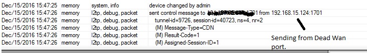

This is a picture of the log when Wan#1 failsover to Wan#1 and you can see it is trying to connect the tunnel from the port of Wan#1. It hasn’t updated the new port for Wan#2
What is the solution for this?
Cheers,
Bumbaa
Try to arrange your routing rules and firewall in such a way that those packets with wrong source address cannot go out and are rejected e.g. with “host unreachable”.
Maybe this will make the L2TP setup fail quickly.

Hey,I wasn’t sure how to do it exactly and properly so I just did it this way:
I activated a firewall rules that would drop all packets coming from source:Wan#1 going to L2TP Server side.
The tunnel client was still trying to re-establish/connect from a dead wan port still :/.
The wan#1 port was disconnected and you could see the firewall still blocking packets coming from dead wan port trying to reach the l2tp server. After 10-20 seconds, the L2TP client started sending connection from the backup Wan#2
