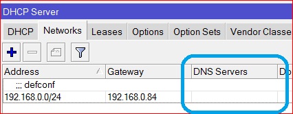

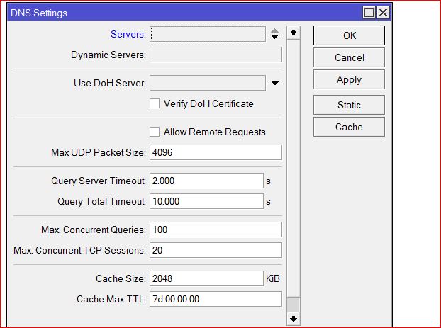

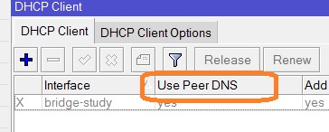

Much thanks for the clarity Sindy and I hadnt even thought about the use or possible misdirection of DNS…
In terms of how to approach this, is there not two clear paths?
  1. Use IP DHCP client settings and if so what do you put in for the regular IP DNS settings??
  2. Use DHCP dns settings, like 1.1.1.1 for LAN1 and 9.9.9.9 for LAN2 but as above then what do you then put in for regular IP DNS settings.
These two questions are only loosely related. It is up to you what you define as the DNS servers under /ip dhcp-server network, whether the Mikrotik itself or some other servers. But if you configure nothing, Mikrotik will forward the server addresses it has received as a DHCP client on the WANs.
As for what the Mikrotik itself uses - the thing here is that some ISPs do not accept DNS queries that did not come from customer side of the network. So if you let the Mikrotik accept DNS server addresses from both WANs’ DHCP servers, and it sends the query to a randomly chosen server via the “wrong” WAN, the query may remain unresponded, which will make RouterOS use the next server on the list for subsequent queries, until it finds one that responds, and then it will keep using that one as long as it will keep responding.
