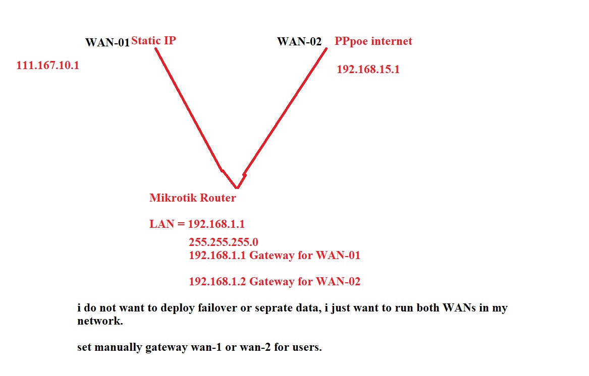

Can you make a network diagram? Maybe than we’ll understand better what you want to achieve.
i have attached a pic of my desire scenario…
please help, WAN-01 is already running in my network i want to add PPpoe internet,

Now i see, the simplest way to do that is divide 1 x /24 to 2 x /25
it will give you two separate subnet spaces:
IP-s: 192.168.1.2 - 192.168.1.126
MASK 255.255.255.128
GW LAN1 == 192.168.1.1/25
IP-s: 192.168.1.130 - 192.168.1.254
GW LAN2 == 192.168.1.129/25
When subnets is made, you can simply add src-nat for each subnet..
Subnet1:
add chain=srcnat src-address=192.168.1.0/25 out-interface=WAN1 action=masquerade
Subnet2:
add chain=srcnat src-address=192.168.1.128/25 out-interface=WAN2 action=masquerade
Is it really this simple? My impression is that dst-nat is done after routing decision is made (which actually selects the out-interface). Which means that src-address property in NAT rules example doesn’t help. Instead it would be necessary to establish two routing tables (with default route via each WAN, distinguished by using different routing marks) and mangle rules that will mark packets originating from each of LAN subnets with corresponding routing marks …
And note that mangling and fasttracking are exclusive, so one has to disable the fasttracking firewall filter rule to make mangling work. This in turn reduces routing performance of router and could happen that routing capacity actually drops below WAN line(s) capacity.
in contradictory i want to say that DST-NAT in PREROUTING chain and it is done before routing decision, not after as you said, check packet flow diagram…
You were right…The second default route will be inactive within the same routing table.
DST-NAT is indeed in prerouting. However, the NAT rules are about SRC-NAT and that’s done in postrouting which comes after routing decision. See routing diagram.
