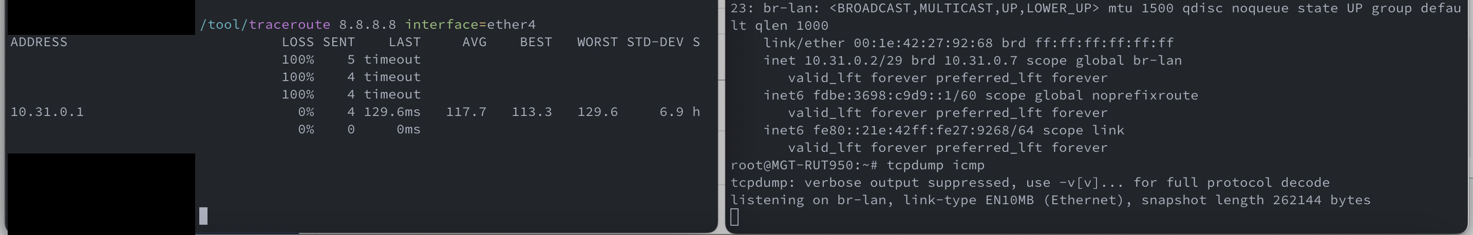

Forced latency in ICMP response causes WAN failover to secondary_route after 2 failed check cycles:
