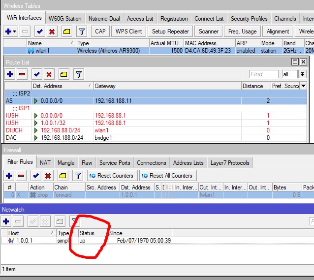

Here is an example, the channel is configured through wlan1 at the moment interface wlan1 is not connected to the access point. If there is no blocked access to 1.0.0.1 through other interfaces, as you can see the route to 1.0.0.1/32 through 192.168.88.1 becomes inactive. However, there is a ping to 1.0.0.1. The netwatch check does not work. Status stays up
